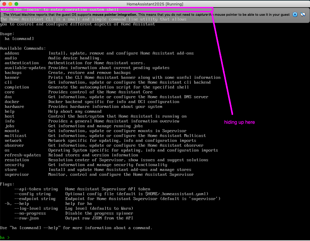

I know this is old thread…but I still had to come searching for this info in 2025.
why is this not listed when you do ha > help ? Running ha 2025.9.2.
I think I need to ditch the ha-os image and deploy ha with ansible instead so I at least can figure out how to deal with securing/configuring the app in an automated/backup-able way.
edit… okay they do tell you, it is just not with the rest of the commands.
