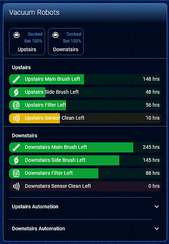

Though I would still need my template sensors to convert the values to hours for the bar cards I use as row elements:
