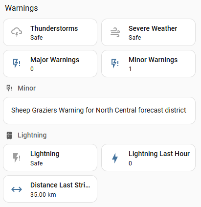

# Template Weather Warning Phase Text - Act as trigger for lovelace conditional card
Note: to prevent early execution of ‘elif’ statement:
  • (new and renewal) may need to change to (new and wal). or just (new)
  • (upgrade and downgrade) may need to change to (up and down) or just (grade)
  - platform: template
    sensors:
      weather_warning_phase:
        entity_id: sensor.devonport_warnings
        friendly_name: "Weather Warning Phase"
        value_template: >-
          {%- for state in state_attr('sensor.devonport_warnings', 'warnings') -%}
          {%- if 'new' in state.phase %}
          {{state.phase | upper}}
          {%- elif 'renewal' in state.phase %}
          {%- elif 'update' in state.phase %}
          {%- elif 'upgrade' in state.phase %}
          {%- elif 'downgrade' in state.phase %}
          {%- elif 'final' in state.phase %}
          {%- elif 'cancelled' in state.phase %}
          {%- endif -%}
          {%- endfor -%}

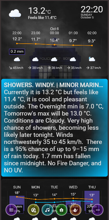

Combining all templates in a Custom: Mushroom Template Card results in the below. This will parse as a complete code.
Card changes colour, Crimson for Major or Minor warning_group_type.
NOTE: sensor.text_dewpoint_comfort_outside is created using Weather Word Descriptions from Dew Point, Temperature, VOC & Tado (Simple Air Comfort Card)
Template to place in Mushroom Template Card shown above:
                card:
                  type: custom:mushroom-template-card
                  primary: ''
                  secondary: >-
                    {{ states('sensor.weather_report_warnings') }} {{
                    states('sensor.weather_report_temperature') }} {{
                    states('sensor.weather_report_conditions') }} {{-
                    states('sensor.weather_report_conditions_2') }} {{
                    states('sensor.weather_report_rain') }} {{
                    states('sensor.weather_report_fire_uv') }}
                  icon: null
                  entity: button.weather_report
                  multiline_secondary: true
                  multiline_primary: true
                  tap_action:
                    action: toggle
                  fill_container: true
                  icon_color: ''
                  card_mod:
                    style: |
                      ha-card  {
                         --card-primary-font-size: 20px !important;
                         --card-primary-line-height: 1.2
                      ha-card  {
                         --card-secondary-font-size: 20px !important;
                         --card-secondary-line-height: 1.2
                         --text-shadow: 0 0 3px #FF0000, 0 0 5px #0000FF !important;
                      ha-card  {
                        {% for state in states('sensor.devonport_warnings') %}
                        {%- if '0' in state %}
                        background: radial-gradient(circle, black, black, darkslategrey)
                        {%- elif '1' in state %}
                        background: radial-gradient(circle, black, black, deepskyblue)
                        {%- elif '2' in state %}
                        background: radial-gradient(circle, black, black, crimson)
                        {%- elif '3' in state %}
                        {%- elif '4' in state %}
                        {%- endif -%}

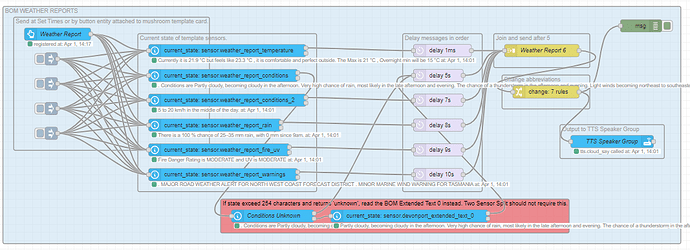

For use in Node Red The state from the sensors below are recombined into the full weather report that can be sent to TTS.
NOTE: There is a 254 Character limit on the condition report. This will return ‘unknown’ if the state of the BOM Extended Text Weather Report exceeds this limit.
NOTE: The state from ‘sensor._extended_text_0’ has been split to two sensors at 230 characters each. This includes room for text prior the condition report.
AVILABLE ON NODE RED FOR IMPORT!

I also have to binary sensors made in the Helpers GUI to give me severe thunderstorms and severe weather warnings using these templates:
Severe thunderstorms:
{%- for state in state_attr('sensor.bom_warnings', 'warnings') -%}
{%- if state.type == 'severe_thunderstorm_warning'
   and state.warning_group_type == 'major'
   and 'central forecast district' |lower in state.title | lower
   and state.phase != 'cancelled' -%}
True
{%- endif -%}
{%- endfor -%}
Severe weather:
{%- if state.type == 'severe_weather_warning'
True
{%- endif -%}
{%- endfor -%}
Then the part of my dashboard with all the warnings and text is nice and neat:

I also do not need the 255 character limit work around in the below flow. As the sensors do not go past the 255 character limit and return unknown.
BTW This is my weather page, responsive design for multiple size screens.
