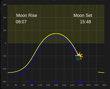

I also wanted that Plotly card to show a different character for the moon for each moon phase. You can do that by changing the annotation for the text field to a sensor:
  annotations:
    - x: $ex hass.states["sensor.planet_moon_az"].state
      "y": $ex hass.states["sensor.planet_moon_alt"].state
      text: $ex hass.states["sensor.planet_moon_phase_icon_char"].state

Now, the plotly card of the Moon looks like this:
