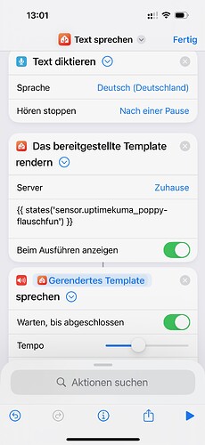

Use the “render template” shortcut offered by the app. It can use any Jinja template.
Good afternoon,
I am struggling with this, do you have a screenshot of the set up shortcut at all?
Many thanks.

Hey,
did you get it solved?
I am pretty unsure how i should continue. Tried a couple of automations and workarounds with assist or to get status of a sensor via voice and ended up here.
Do you (or anyone else) have a solution as of 2025 which is working?
I just want to get a sensor status via voice on ios 18…
