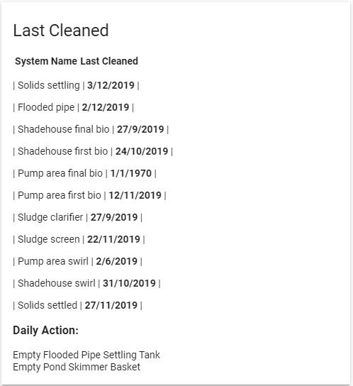

However that did not work as intended. It did seem to work to produce the headings for the table but each row just printed a pipe character beside the output of the loop:
So I played around with the code in the template editor and realised I can get a pretty good representation of a markdown table by stripping out the formatting I had appplied to get some whitespace into my initial markdown card:
CODE:
{% for state in states.input_datetime -%}
{%- if loop.first %}
{% elif loop.last %}
{% else %}
{% endif -%}
| {{ state.name | capitalize }} | {{ state.attributes.day }}/{{ state.attributes.month }}/{{ state.attributes.year }} |
{%- endfor %}
OUTPUT:
| Solids settling | 3/12/2019 |
| Flooded pipe | 2/12/2019 |
| Shadehouse final bio | 27/9/2019 |
| Shadehouse first bio | 24/10/2019 |
| Pump area final bio | 1/1/1970 |
| Pump area first bio | 12/11/2019 |
| Sludge clarifier | 27/9/2019 |
| Sludge screen | 22/11/2019 |
| Pump area swirl | 2/6/2019 |
| Shadehouse swirl | 31/10/2019 |
| Solids settled | 27/11/2019 |
