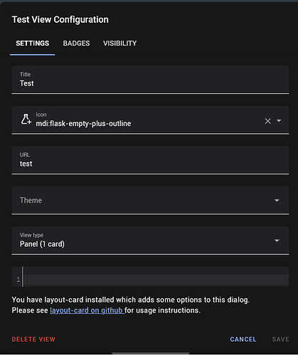

Try like this my friend. Set your Edit View Settings options and Save.
Then add a Manual Card and paste in this code

Change the width to your liking to suit your device. The above value was for a wide screen TV, so will not be suitable for a phone/tablet setup. Maybe start with a smaller value and increase gradually to suit your device.
All the best. Let me know how you go with it :+1:
