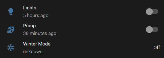

Despite being one of the most requested features over the years (2019, 2020, 2022, 2024), HA does still not offer a way to make the “last changed” timestamps (common with the “Entities” card) persist a reboot of Home Assistant. So I wanted to share a practical and manageable workaround I came up with.
The way it works is that you put the ID of each entity for which you want to retain history into a text file. A Powershell script uses this to build a YAML file, storing everything in attributes of a template sensor. Then you reference this in the entities cards.
In this example, we have a hot tub with 2 toggle-able entities, and a binary sensor:

Step 6: Referencing new data from the dashboard
Home Assistant’s built in Entities card does not allow custom data to be shown in the secondary / time stamp portion of the row.
To accomplish this, we’ll add a custom module called Template Entity Row, which is available from HACS.
Expand for new YAML code

Note the following changes between the old YAML above and the new:
  1. We add type: custom:template-entity-row to each entity.
  2. We remove secondary_info: last-changed, replacing it with secondary, which contains a reference to the time conversion file from the last step.
  3. Any line that would normally have a toggle, rather than displaying the current state, should have toggle: true added.
  4. The binary sensor showed off instead of Off, so I use some Jinja under state to capitalize the first letter.
  5. The icons no longer change color based on entity state. We can fix this with Card-Mod.

Conclusion
That’s all there is too it! To add more entities, just add to the text file, run the script, reload YAML in HA, and update the card. Feel free to comment if you have any recommendations/tips.
