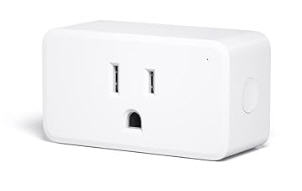

#2. Smart plugs. IMO, Third Reality again here. A powered plug is going to give you pretty good routing, brand is probably not an issue here.
#3. INNR bulbs on amazon. There are bulbs that are routers if you have wifi bulbs you could replace them with. Beware, they are a router, but not a great router. Plugs and/or the nightlights would be a better choice.
Given your map, a few of those nightlights would really improve the network and you could find functions for them, that’s what I would look at.

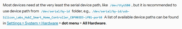

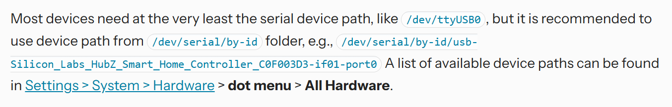

Note that it is safer to use the long serial/by-id instead of the device path (ttyUSB0) for the port: config, since the latter is subject to change if you unplug the dongle.
The below is from the ZHA docs, but it applies equally well to any integration which uses a USB dongle, including Z2M
