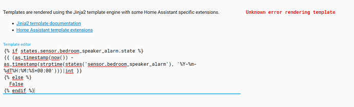

{% if states.sensor.bedroom_speaker_alarm.state %}
You can force it to update with the homeassistant.update_entity service call. Calling that every second is left as an exercise :slight_smile:
Unfortunately, still unknown error rendering template.
and i don’t have sensor.bedroom_speaker_alarm
I don’t know. Am I missing something?
If the sensor does not exist, states() returns “unknown” which evaluates to true in a condition.

When you have the problem, print out the value with {{ states('sensor.bedroom_speaker_alarm') }} and go from there. Maybe you need something like this
{% if (states('sensor.bedroom_speaker_alarm')) != "unknown" %}
I think the problem ist the template when the if evaluates true.
Unavailable instead of unknown and it finally works! Thank you!
