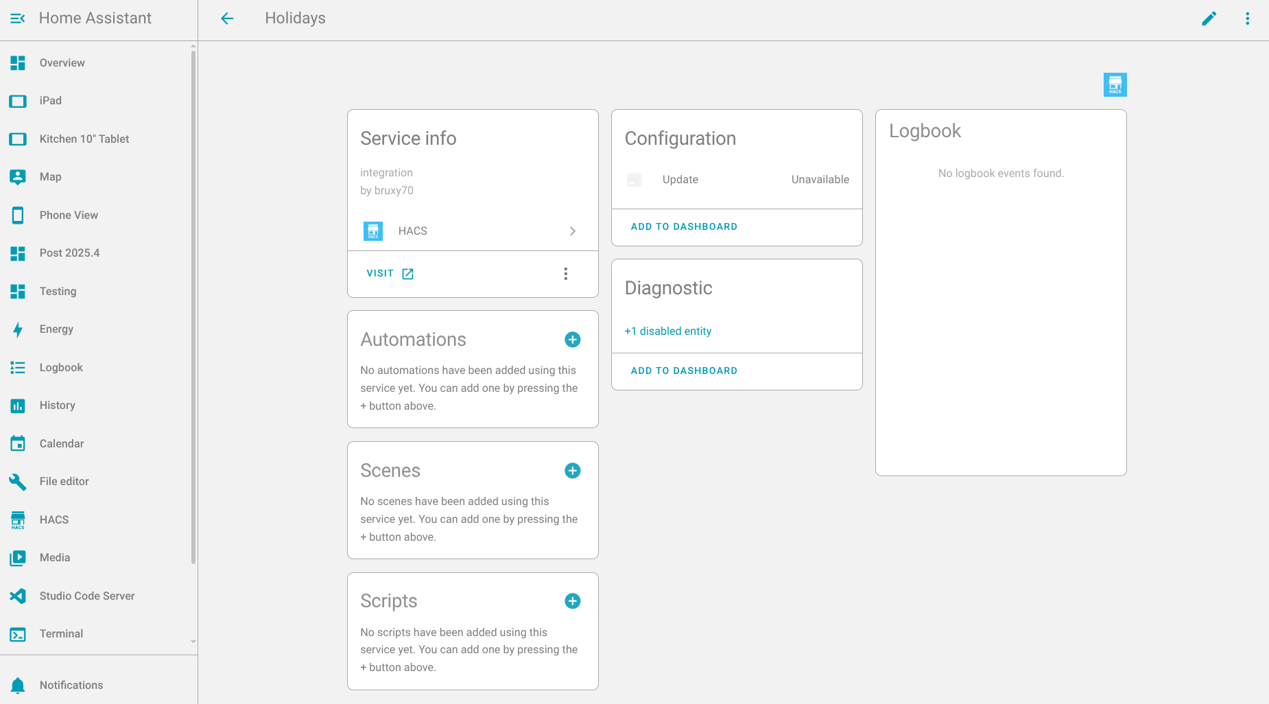

If I go into Settings → Devices and Services → Integrations, HACS is listed and has 17 “services”. If I click on the services, one in the list is “Holidays”. If I click on that, I get this image:
If I click the three dot menu in the top right, the only option is “Recreate Entity IDs”. If I click the pencil in the top right, I get the usual Name, Area, Label options and a switch to “Enable/Disable” service. If I click the three dot menu next to “Visit” under Service info, I get … and if I click the “Visit” link, I get a message saying “Repository with ID (447307317) not found.”
