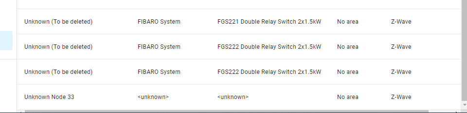

Here’s an example of one of them.
There are no connected entities and I do not see any delete button.
Also they do not show up under Entities or ZWave configuration, so basicly they are ghost devices. It seems this happens when removing devices from the mesh.

I had given them easy names ‘Unknown (To be deleted)’ so you can search on them.

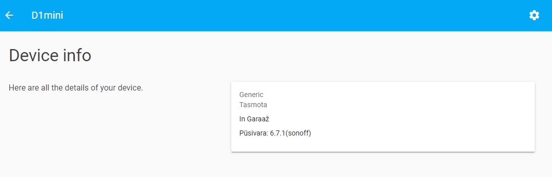

Would I be able to remove failed MQTT devices using this method? I have a device with no entities, and I’ve not delved into the hidden .storage folder before
