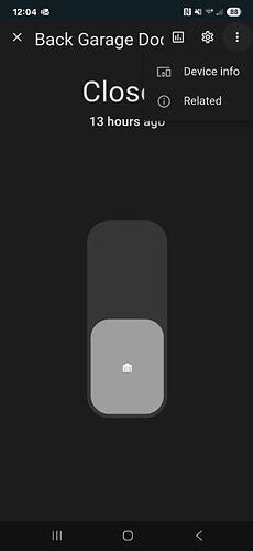

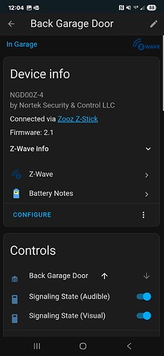

So go up a level for entity to device. (you should be able to find it from - related- in the three dot menu)
Entity :
Related Device :
(all the other entities)

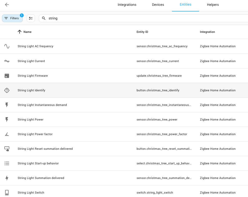

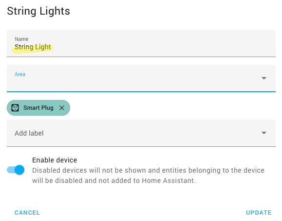

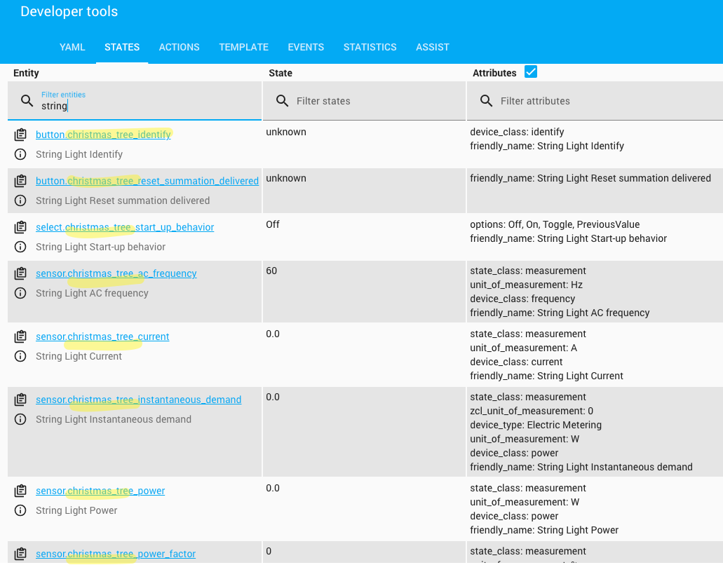

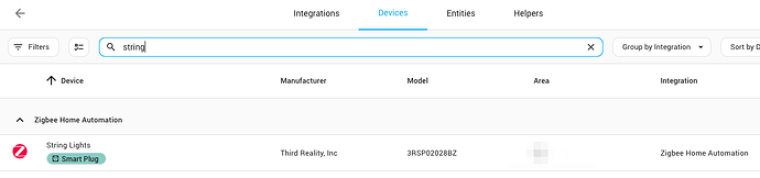

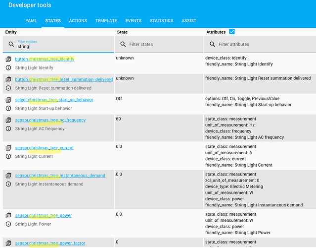

Okay I did that, I renamed it from String LIghts to String Light to make a change, however all of the other erroneous names still say something like christmas_tree_power, christmas_tree_sensor, christmas_tree_current, etc…
In the screenshot look at the hyperlinked blue text.
Change your device name to Christmas tree, click no to renaming entities. Then change device name to something else, then click yes to renaming entities.
The system is simple. It simply renames the common words with the device name at the start of your entity id.
Okay so I renamed it back to Christmas Tree, nothing pops up asking me whether to renaming entities, is that a setting? I then renamed the device back to String Light, again nothing pops up to asking about renaming entities.
Maybe I’m doing it in the wrong place, or do not have something enabled?

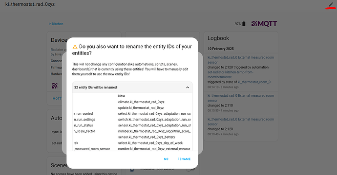

Odd, seems to work here. Not sure where you renamed the device. If I rename the device from the device info page with the pen symbol in the top right then I get a popup asking if I want to rename all associated entities too.
Did you rename the “base” entity only per chance?

  3. Next I went back to the device info screen and clicked on the top right pen symbol (marked with red in the below screenshot) which then got me to a popup allowing to change the device name. Here I renamed the device adding a xyz to the name so that it has rad_0xyzin the name.
    Clicking Update got me a popup asking if I want to rename all entities. Expanding the entities list it then looks like this:
    I see all the entities with old and new name. The heat_required is a outlier with rad_0xxyz ,e g. the xyz got added there too keeping the previous x in the name.
    Clicking renamerenames all the entities as anticipated.
    After this the dev tool view looks as expected now too with all entities related to this device having a rad_0xyzin the name except the head required one which has rad_0xxyz.
