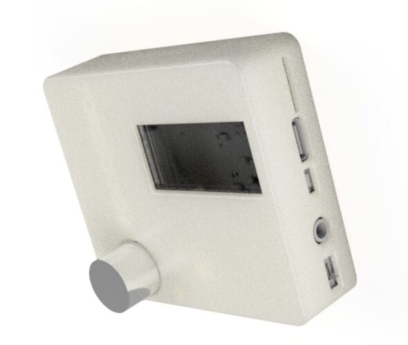

I had my Chromecast Audio connected to a pair of Pebble USB speakers. I replaced the lot with this:
If you want to connect to an existing amp they have this:
Though I have no experience with it, if it is anything like the other Muse products it works extreemly well with Home Assistant.

Wow - reading up on this and watching their video now - this is what I’ve been looking for - I think.
The reason they have been out of stock is Home Assistant Users. There’s a review and tutorial here: Build Your Own Smart Home Speaker With ESPHome! - YouTube
