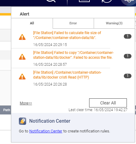

But when I try to check further that file with File Explorer that folder I get the below message
How do I move/copy that folder from there?
I have tried normal copy/paste to other location but …
