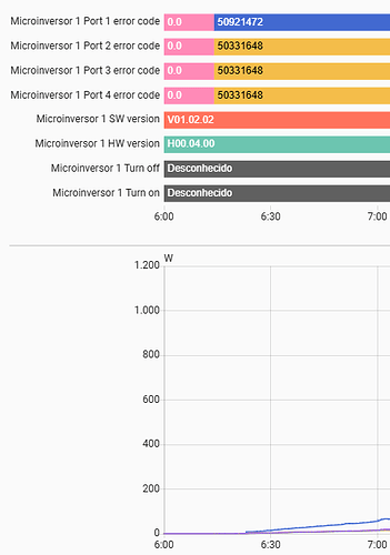

Also I would like to find more information about the meaning to the error codes. I did not find anything on google yet. My error codes are:
  • port 1: 50921472 = 0x3090000
  • port 2: 50331648 = 0x3000000
Maybe they indicate that there is no internet connection?
I am using the same setup from suaveolent with an HMS-800W-2T and it works fine with a 35 sec. update interval. I also use the Hoymiles cloud apart.
I also get the same errorcodes and cannot find any information - every day the same codes at these ports.
  • port 1: 50921472
  • port 2: 50331648
    → would be nice to know what it means. THANK YOU.

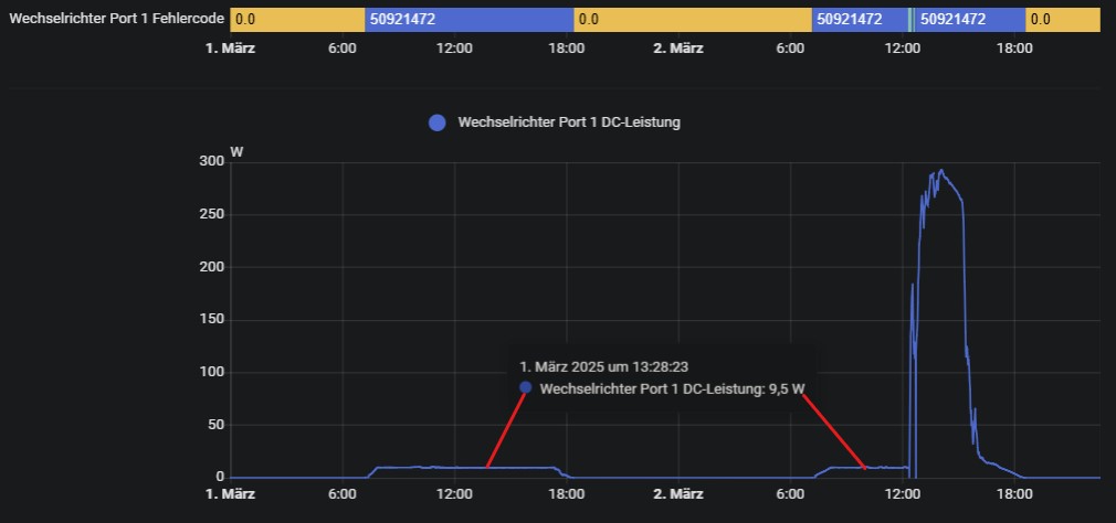

I think, i recognize the same (much more serious) error in your graph, that i see in my inverter.
Since the “Port 1 error code 50921472” show up in the HA add-on,
my inverter has been capped at 19.x W (both ports together).
Today I experimented a little:
If I leave HA active, the power curve looks like the one on the left.
Max 10W - all day, everyday.
Today around 12:00 I initially only restarted the DTU via the S-Miles Cloud website.
That didn’t help and A few minutes later I restarted the inverter.
Suddenly the port then supplied over 250W instead of 10W!
After 1-2 days, the inverter will hang again. (hoymiles cloud shows no errors, btw.)
I will now leave the addon switched off for a few days and see if the inverter runs fine again.

Regarding codes, same here with the HMS-2000DW-4T. Only port 1 gets a different code. It does not seem to affect the generation, though.
Any updates on the meaning of it?

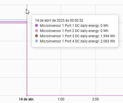

  2. Another issue: does anyone else have this problem related to the reset of daily sensors at midnight? Not sure if this is a microinverter timesync misconfiguration or just some delay in HA processing, but it affects my history graph, since I am considering the max value of these accumulators each day. I get same value for two subsequent days since the previous value “leaks” to the new day.
There might be some different way to plot this graph, maybe use a specific time each day instead of max value, but the whole HA thing is new to me. Any
tip is welcome.
