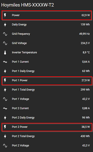

I think something is calculating the total power wrong:
Should be 66.4 instead 62.9W
I am reading this value directly from the DTU and not calculating it.
My guess is that this might be due to conversion loss due to DC → AC (or some internal quirks) or the inverter consuming some of this power.
I suspect “Port 1/2 Power” is DC and “Power” is AC.
In any case, I cannot really fix this since this is the value the inverter reports.
