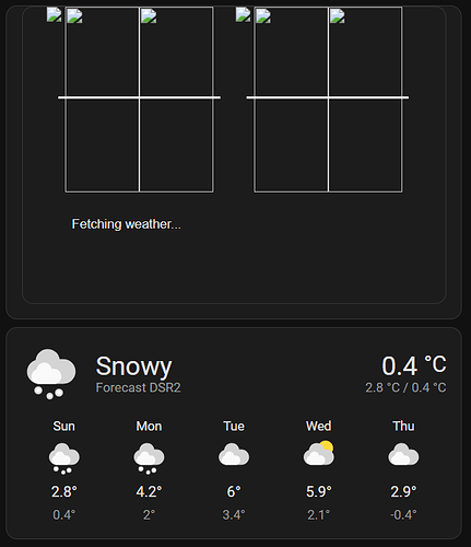

Hello new here to home assistant… im designing my dashboard & I can’t get this card to work to save my life… I tried everything even copying others code & it always shows up the same… can some one please help!!!
Here’s how it shows up & heres my code
How it look on my dashboard
Have you changed the weather-service?
Try openweathermap or a weather-service you want.
First you have to install a weatherservice. Look in intergrations. There you can find several weatherservices. Install one you wish.
After that go to your dashboard with flipclock.
Edit dashboard, 3 dots upper right.
Edit flipclock.
Change the entity: for example weather.openweathermap.
Thanks for the response… I use the AccuWeather integration… I believe the weather entity I used in the code is tied into that but I’m not entirely sure… I will check that out & I will try exactly what u said & or 1 of the other weather services. I will let u know after I try it thanks again
Still doesn’t work!!!
Have you version 1.3.2 installed?
Is the path in your config folder www/custom_ui?
Here you have to add the folder htc-weather
Did you add the resource?
/local/custom_ui/htc-weather/htc-flipclock-weather.js?v1.3.2
You can do it in settings → dashboard → three dots upper right → resources. During adding it, choose javascript-modul.
I have the latest version 1.32… I installed it thru HACS
I also added the resource before thru the settings in the dashboard… but I do need to check the configuration folder & see what’s in there
You find it in your config folder → www/custom_ui → htc-weather.
I found the file in my configuration & everything is there but still doesn’t work here is the path file name of my files in resources
This is what i added under resources.
Delete your resource and add this.
Click type js-modul and save.
Look also here: GitHub - iamBiB/lovelace-htc-flipclock-weather: HTC Flipclock with Weather card
Scroll down to CLI Install.
Don´t forget to add the time_date platform in your config.yaml.
Copy paste the lines above cli_install.

Did you find a solution to the problem? I seem to be stuck with the same issue.
First installed via HACS, then tried to move the files to the suggested location and update the link in the resources accordingly but without succes.
The weather integration works fine as seen in the card below
Any help is appreciated! Maybe there is an alternative card that can be used?

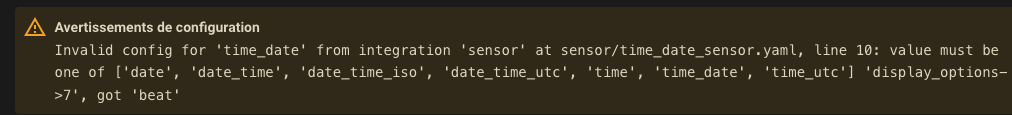

Hell all
Mine appear for a few seconds, then disappears.
Could it be linked to the removal of beat? What could we do?
Same here despite the fact i’ve installed back swatch Beat using this repo :
https://github.com/andrewjswan/SwatchTime
I’ve only got black screen for the card and sensor continue to complain about beat :
@ibBogdan Are you still among us ?

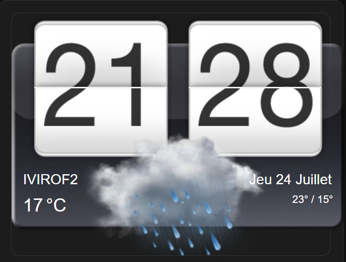

I solved my problem with github copilot on vs code. I’m not sur I can post the result here, but I try. This is the file htc-flipclock-weather.js
I don’t know what was changed, I just explained my problems, and Copilot solved them.
Now it works
