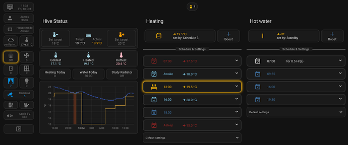

My dash looks like this (happy to share that code as well). Note: the water is ‘on’ right now.
Here’s the same dash with one of the schedules and the defaults expanded:

The automation is actually quite simple, the ‘brains’ are in sensor.hive_heating_target_temp
Note that the automation uses other sensors including:
states('binary_sensor.hive_heating_doors_windows_open'). # are any heating relevant windows open? (excludes front door)
states('zone.home') # Is anyone home?
states('sensor.time') # what time is it? ...from system_monitor integration
states('input_select.house_mode') # is my house 'awake', 'asleep' or in 'manual' mode?
Note there are 2 boosts:
- The 1st is ‘normal’ (controlled my
timer.hive_heating_boost
) and can be set by time or temp rise. Merely starting this timer sets the hive to ‘boost’
- The 2nd is 'special (controlled by
timer.hive_heating_boost_bathroom
). This is fixed to 30 mins and goes off when house_mode
goes from asleep
to awake
& it’s a colder day & the heating isn’t already on. This is for my mum who has a single-channel receiver (no hot water control) who likes to have her bathroom radiators warm when she showers in the morning. 30 mins is enough to do that without heating the house up as well. You can remove any code related to this if you have a 2-channel Hive receiver. …I only have this as I maintain mums HA and we share this package. Leaving it there and ignoring it also works
…bet you wished you never asked
Have a read and ask any questions you like
