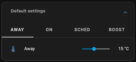

So, homing in on the ‘default settings’ drop-down…
Away defaults:
On defaults:
Schedule defaults (1st scheduled window showing):
‘Boost’ defaults:
