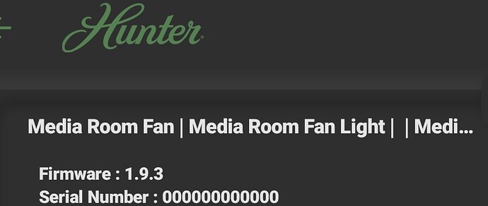

Edit: Something I’ve also noticed, is that SIMPLEConnect reports the serial id as 0 (a bunch of zeros). I noticed that there was a recent update for the Homekit Controller integration to support devices with poor serial number reporting…wonder if it’s something around that?

Also @DaveKram I used to have that issue where the simpleconnect app wasn’t showing the serial number too. Since I got the newer firmware pushed to me, it displays in the app as expected. However, that doesn’t seem to have affected the homekit connection issues.
