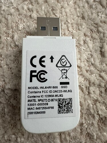

I have four Hyundai air conditioners which can connect to Wi-Fi using a USB dongle that’s included in the AC.
Even though these air conditioners are Hyundai, the app used to manage them is named “TCL Home”.
tcl
So I suspect someone else manufactures these air conditioners, sells them to Hyundai, and TCL provides the smart functionality. This is the information of the AC.
Any chance I can integrate these with Home Assistant?

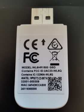

I discovered that some of my AC’s are using a different model USB dongle. And from my research I found that this model is actually made by Tuya. Still though I can’t get the AC to connect to the Tuya app. It just can’t find the AC.
I guess even though it’s made by Tuya, each manufacturer implement’s their own features?

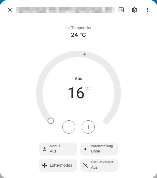

I finally got around to integrating my TCL air conditioner.
I used the tclac integration by I-am-nightingale along with the translation by sorz2122.
Everything works very well, and I’m really happy with the result:

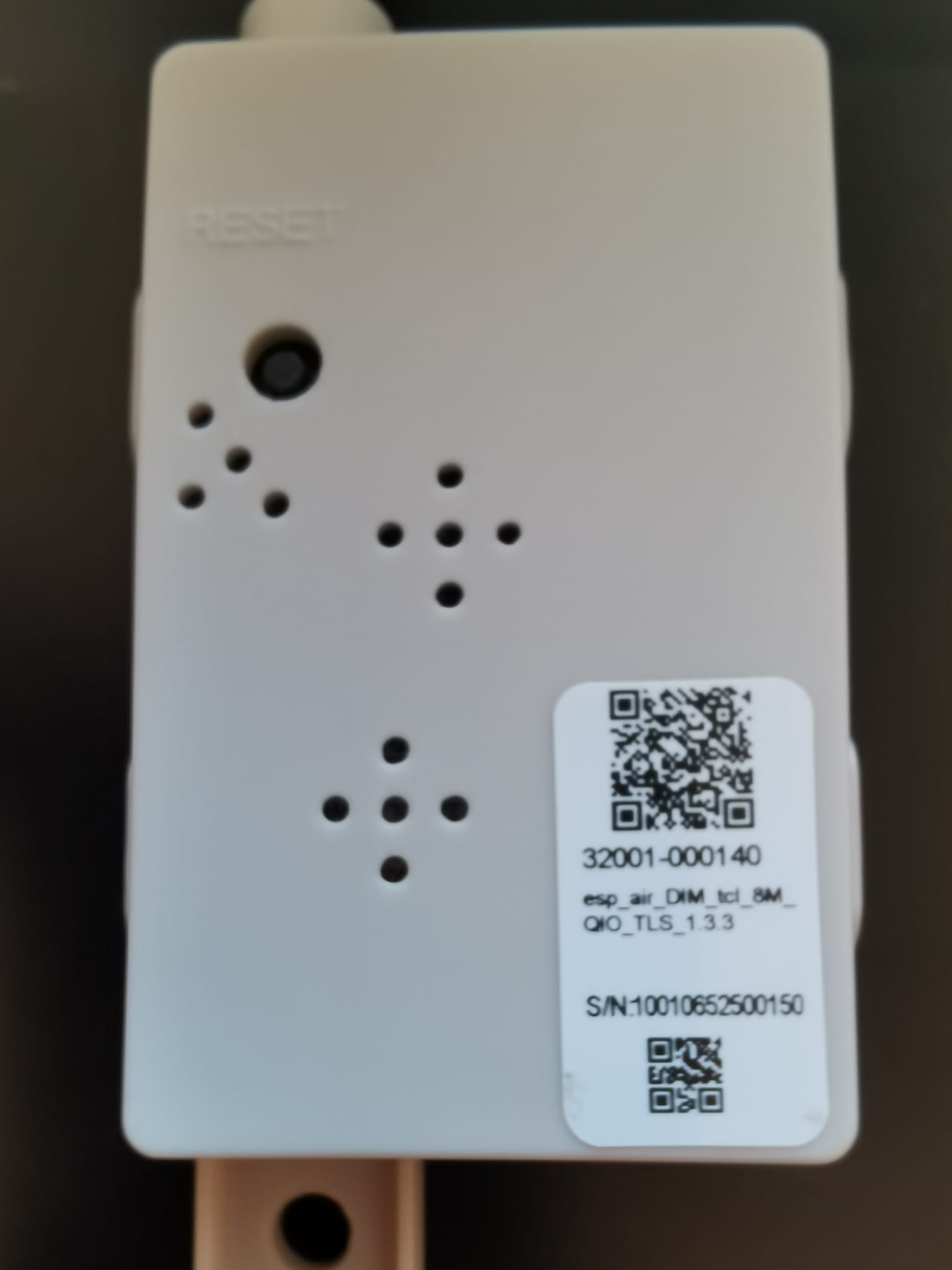

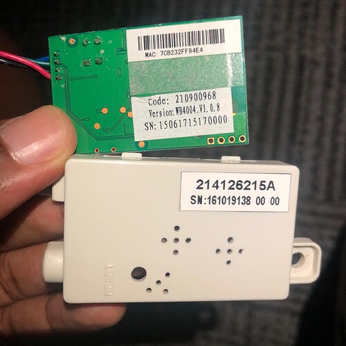

I also have another unit – a Kältebringer Split Air Conditioner, 5.1 kW / 18,000 BTU – which uses a different WiFi module. However, I discovered that this model is also manufactured by TCL.
Upon inspecting the mainboards, I noticed they look almost identical, and the WiFi module connector has the same pinout. So I tried connecting my ESP32 module to it – and it worked perfectly!
Now, I can control both of my AC units – the TCL (TAC18CHSD/TPG11I-QC) and the Kältebringer – using Home Assistant.
TCL WiFi module::
Kältebringer WiFi module:
From what I’ve read, this WiFi module is also used in units sold under various other “brands.”
