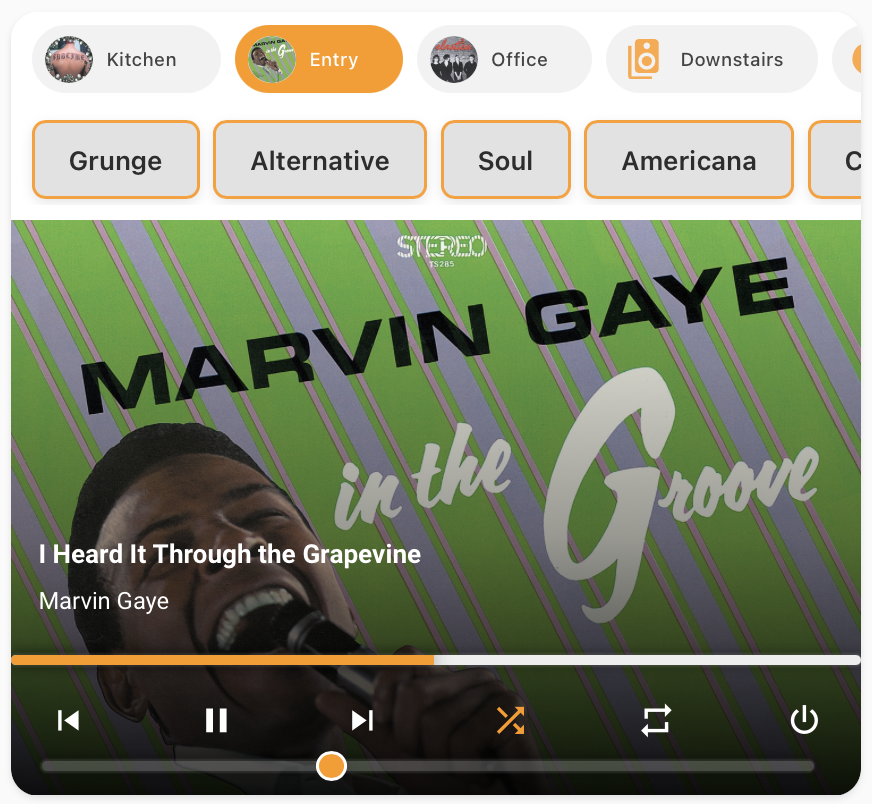

I created yet another media player card
It started out just wanting a card I could simply load my entities into and it auto switch to the most recently playing one. I’ve been actively adding to it with a bunch of stuff I find useful and I hope you do too!
Some key functionalities include:
Ability to add custom actions on the card that target the currently selected entity by putting “current” for the entity_id for any home assistant service. I’ve used this to play certain genre playlists or switch to a specific source on the tv.
You can toggle match_theme on to inherit your home assistant accent colors.
You can toggle collapse_on_idle on to shrink the player down when it’s not playing. This looks pretty nice on mobile. That feature and always_collapsed (so collapse even when playing) are currently in pre-release as I have some bugs to work out).
When you manually select an entity chip, it will pin that chip in place so it doesn’t auto switch for that session, tap the pin to unpin.
I wanted to keep the config relatively simple while still providing a lot of functionality. This is my first real submission to the community and I’d love for you to check it out. It’s in HACS so you can just search for Yet Another Media Player.

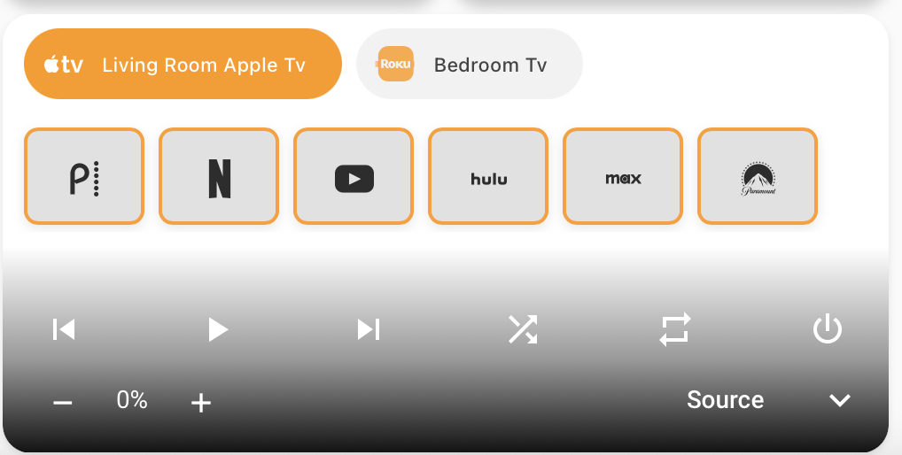

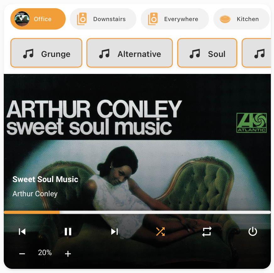

Some screenshots

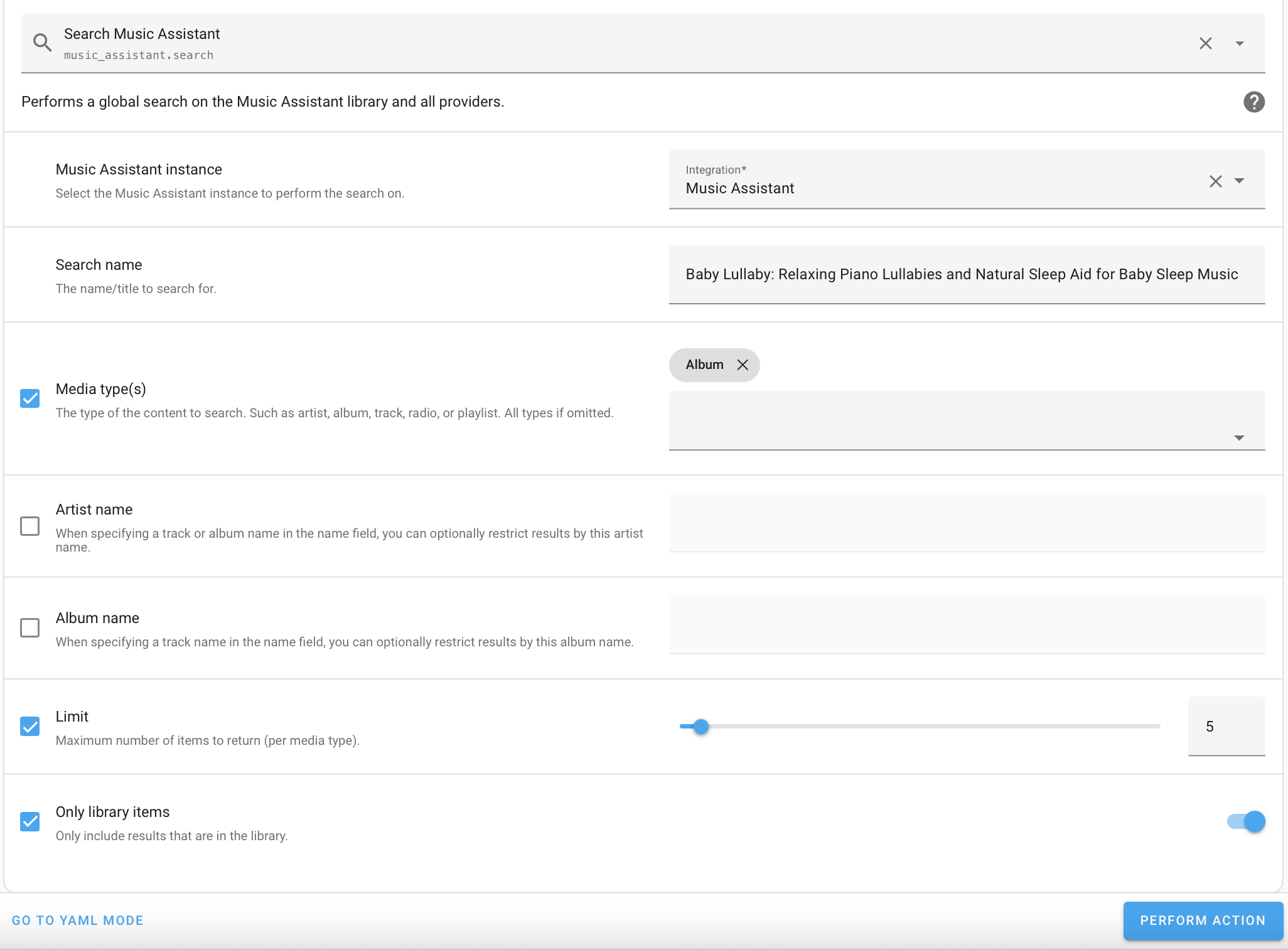

I really like this. I have been playing around with something like this myself. My wife is not techy and although she can use her iPad, does not like to browse or drill down into menus. This solves the problem. The only thing I can’t get to work is my Apple Music playlists. The public ones work fine as I was playing around with yours. But the private ones are hard to get. Sometimes you can get them through developer tools->state. But that doesn’t always work. When it does, it won’t randomize the playlist and seems to jump into other playlists. Have you worked with this at all and had any luck? Would be interested if you have any suggestions or ideas.
Yeah, this is how I accomplish this. I go to Developer Tools → Actions and run the Music Assistant Search Action and choose “library only”
and then you use the resulting uri that starts with library (e.g.: library://album/11000)
So in my card, you would do something like this
actions:
  - icon: mdi:baby
    service: music_assistant.play_media
    service_data:
      entity_id: current
      media_id: library://album/11000
      enqueue: replace
Since you mentioned playlists specifically, you would just change where I had album in my media type to playlist and use the uri for library://playlist/xxxx

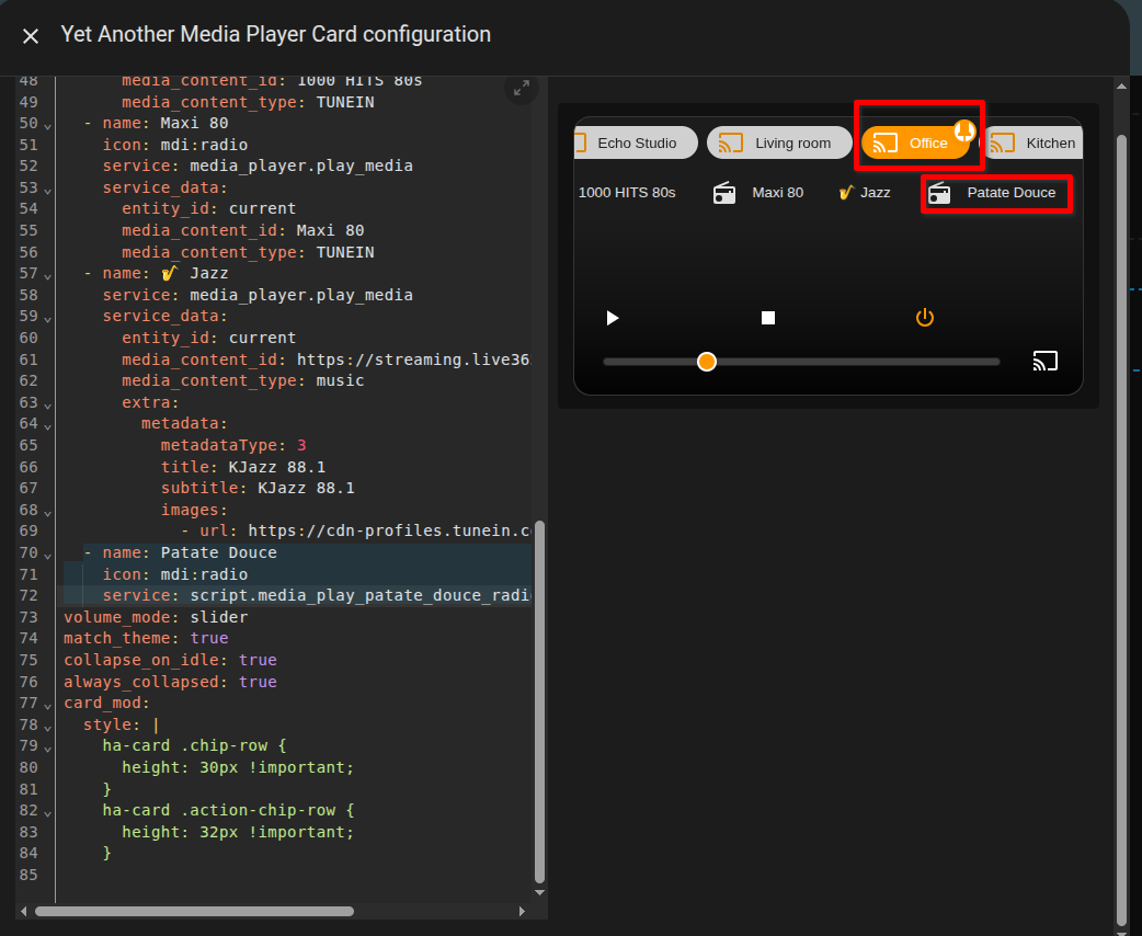

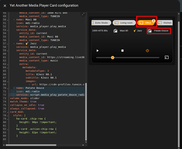

I was reading the documentation of those new features and I was able to improve my code above.
Here is the script called script.media_play_patate_douce_radiobrowser_yamp:
(it is no longer associated to a hard-coded speaker!)
alias: "Media: play Patate Douce (RadioBrowser YAMP)"
description: ""
mode: single
fields:
  yamp_entity:
    description: Target media player
sequence:
  - data:
      entity_id: "{{ yamp_entity }}"
      media_content_id: tell radio browser number 20
      media_content_type: custom
      enqueue: replace
    action: media_player.play_media

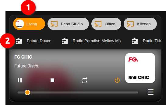

and the new name in the v19 card (I have shortened the list of names and removed the card_mod below):
type: custom:yet-another-media-player
entities:
  - media_player.echo_studio
  - media_player.office
  - media_player.kitchen
  - media_player.living
actions:
  - name: Patate Douce
    icon: mdi:radio
    service: script.media_play_patate_douce_radiobrowser_yamp
    script_variable: true
volume_mode: slider
match_theme: true
collapse_on_idle: true
always_collapsed: true
Remarks:
  • I don’t see the Group Players entry in the hamburger menu.
  • I select a speaker then my Patate Douce stream. The radio starts but the previous artwork remains although I specified enqueue: replace in the script (but it seems to be the same with other stations and I thought this worked before :thinking: ).
