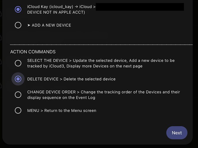

I will check it out. It probably has something to do with the ‘Device not in Apple Acct msg’ displayed on the first screen.
Edit: What version of iCloud3 are you using. I just tried it on a beta version on my computer and it seemed to work. I will be releasing it Friday (iCloud3 v3.3.5).
Edit 2: Can you do it again and get the same Unknown Error Occurred. Then go to HA Settings > System > Logs and look for an error. It will probably be at the top of the list and might not say iCloud3. Let me know what the error says.

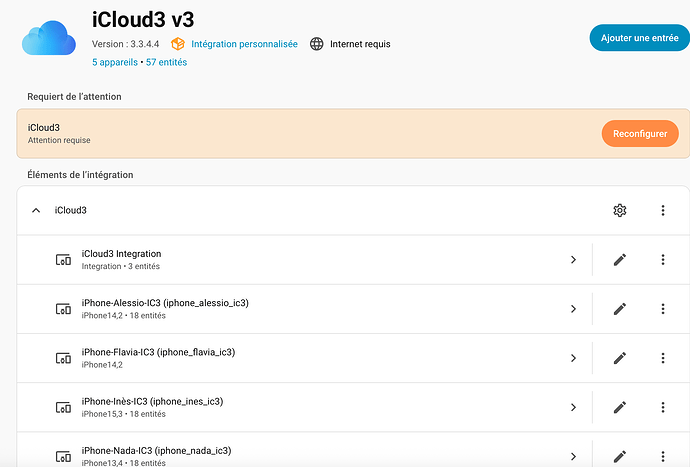

Hello Gary,
Coming back to this issue where the entities for my daughter’s mobile are not showed.
You mentioned about release 3.3.5 handling this … do you have any clue when / how it will be released ?
Many Thanks for your support.

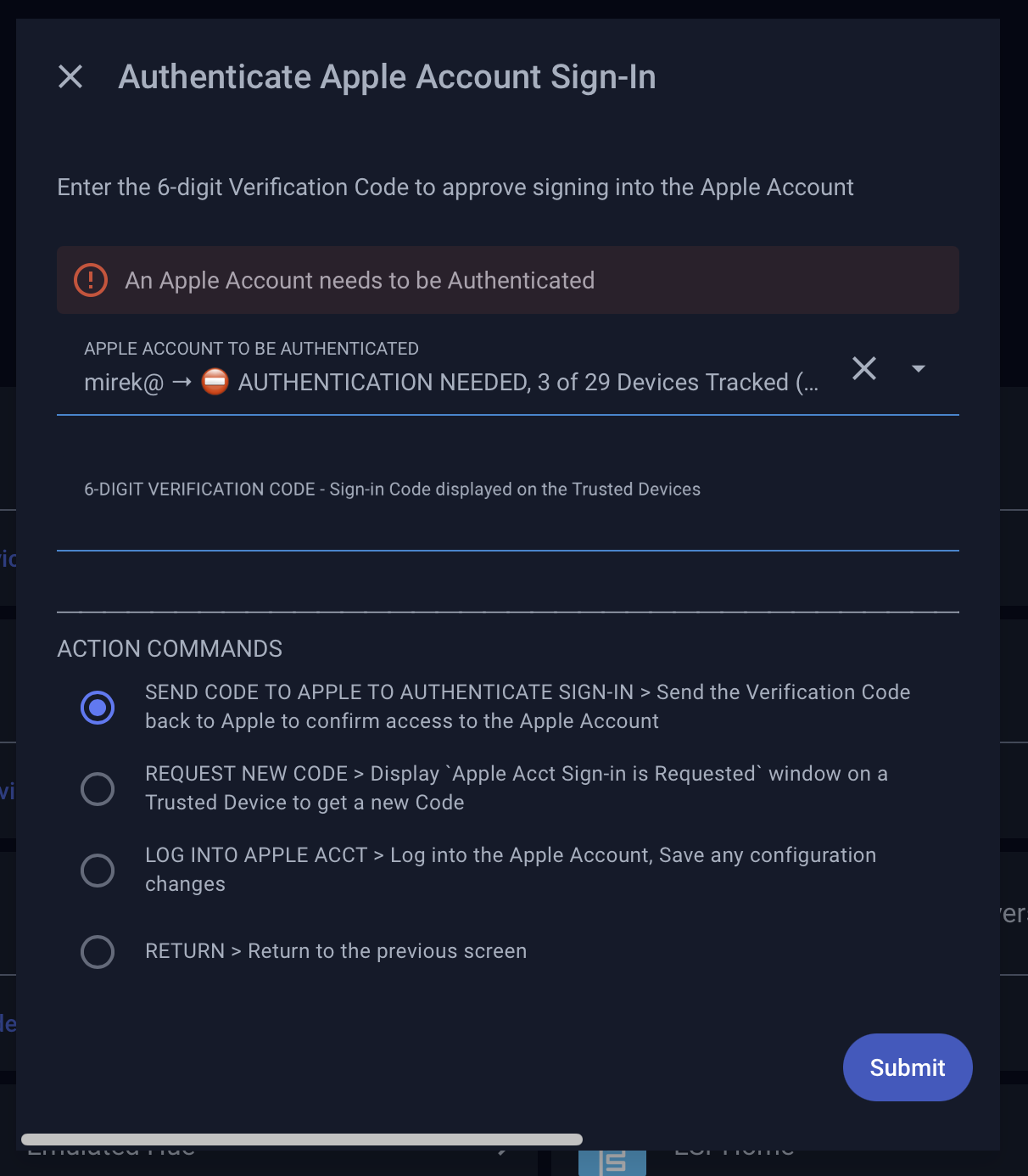

My system just started to fail (few hours ago), cannot authenticate. Seems that even login is not passing through, so when I request new code there is no code send back to me from Apple:
Anyone facing similar problem? Any idea how to fix it?
@mirekmal
Apple has made some changes. I hope to have v3.4 out this weekend. Meanwhile, see here for a zip file of v3.4b1.
Go to the top of this issue for a change list
After updating to this beta version and simple reloading of integration everything instantly started to work again! Even without re-requesting authentication. Thanks a lot, Gary!

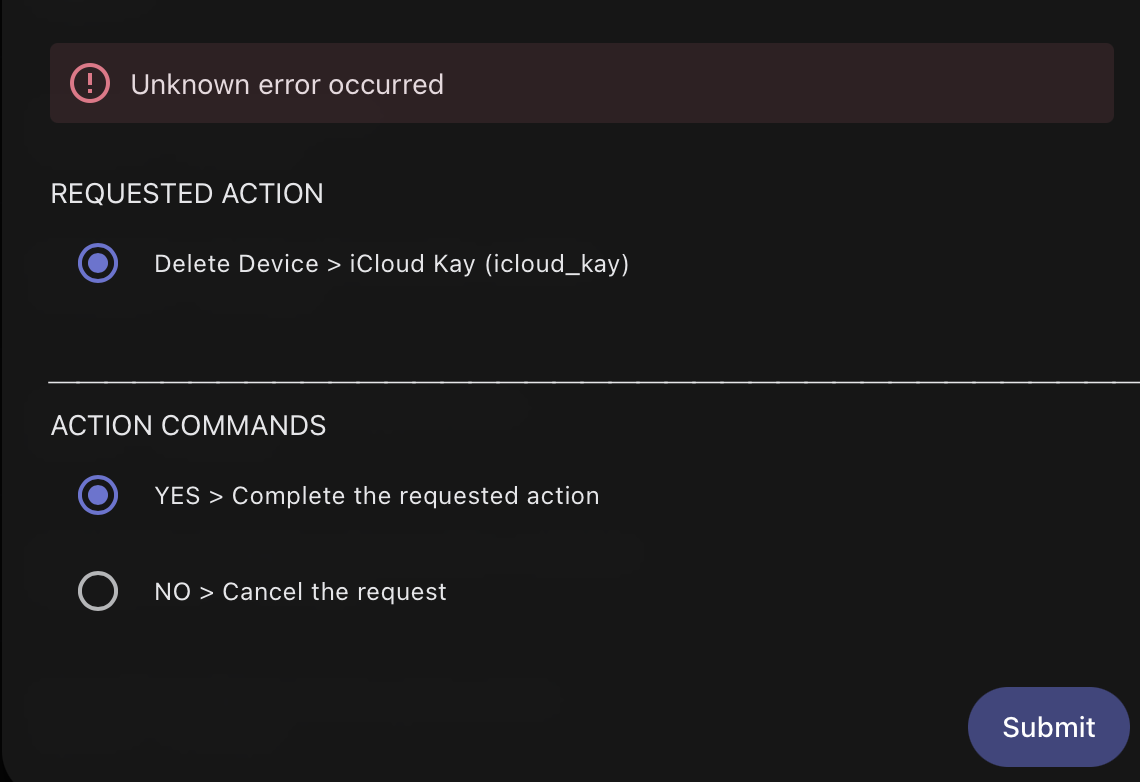

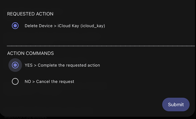

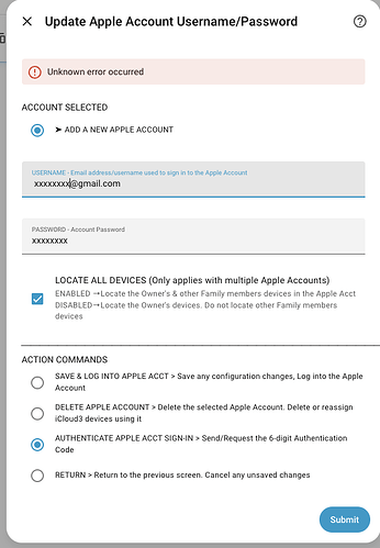

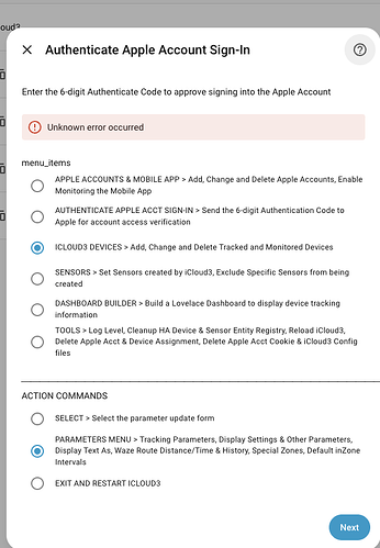

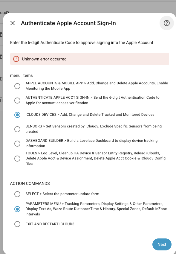

I’m battling the auth. I got as far as typing in the AUTH that id.apple.com gave me, without typing it in to the wesite. But I get an unknown error so I tried to delete, reboot and try again, but now i get it here instead:
Looks like I got past this bit and was able to add three devices in the end. Now I’m trying to set zones to call the devices at home, and I’m getting no further than this unknown error again.
