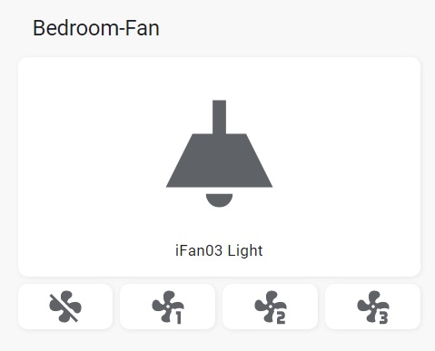

The post below is good for fan control, in my files if you have a look a the lovelace dashboard file you will see that in order to set the fans to a certain speed, i use the following service calls:
          action: call-service
          service: fan.turn_on
          service_data:
            percentage: 33
As the fan is one entity the same as a Light Bulb, you only have on entity listed for the fan which can be accessed for and the speed adjusted on a slider. To overcome this issue and for WAF i decided to use the service calls instead on a four button layout.
iFan03_DashBoard
As for the error that you are experiencing, this is normal, with the Sonoff Device like ifan03.

I'm not sure the light bit is right and haven't tried to put the buzzer function back in or even if I want it?
Again, I've not got it connected to the fan as it's stripped down but I can hear all 4 relays work when I toggle them on the HA desktop and all the entities appear as expected when you add that ESP integration.(I'm not sure about the purity of the light part though)?
Because the remote supplied with the iFan04 feels a bit crude in use (and I can't read the icons), I may well just find a 'better' Zigbee remote or make one using an ESP32.
My Mrs, although now struggling with the early signs of Dementia can sill use her HA desktop on her smartphone to open / close the curtains and turn the main light on / off so should also be ok with the fan as the 1/2/3 Slow/Med/Fast controls are more intuitive to her because of the existing 'cyclic' pull string and radio push-button type fans we have here.
I really wish this coding lark didn't put my head in a spin (it's like trying to make sense of an alien language to me) as then I could do more of what I want without having to bother anyone. ;-(
