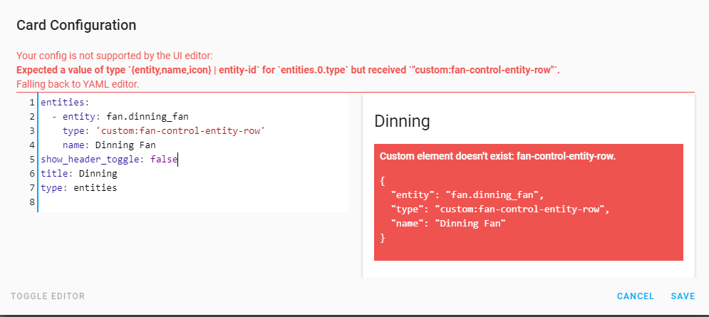

i am getting the above screenshot error , where is the problem ?
2019-07-27%2021_38_44-Home%20Assistant 2019-07-27%2021_36_23-fan-control-entity-row
2019-07-27%2021_44_23-Home%20Assistant
Two things:
1 did you restart HA after you installed the card?
2 I’ve never used the UI editor for anything but I’m not 100% sure it supports custom cards (and the error kind of says that). you probably will have to go into the raw editor and add it there.
Otherwise the config in the screen shot looks OK.
EDIT: are you using lovelace thru yaml mode or thru the ui editor?
