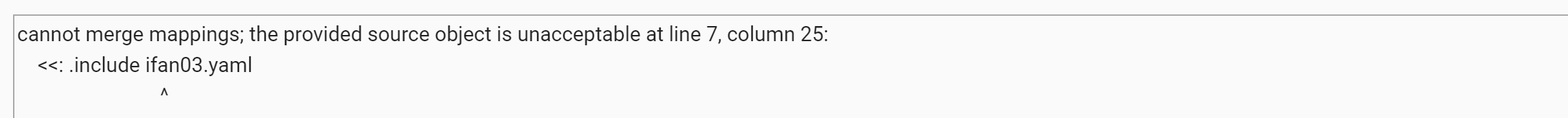

Hello @finity, and thanks for the code ! I am trying to make it work with an iFan03 and ESPHome.
The good :
  • flashed the unit, integrates into HA, i can turn it on and off

The code uploads fine with this problem though (in the ifan02_test.yaml file)
I am sure i missed something but don’t know what…perhaps you can spot it.
I am using the fan-control-entity-row from here : https://github.com/finity69x2/fan-control-entity-row , Low and Medium have no effect on the fan, while ā€œhighā€ turns on the fan.
Big caveat though : I actually have not installed it in the ceiling yet , I have it hooked up to this : https://www.amazon.com/SUNON-SP101A-1123HST-GN-2550-Sleeve-Bearing/dp/B00DE2RYWI/ref=sr_1_2?hvadid=77927948435095&hvbmt=be&hvdev=c&hvqmt=e&keywords=sunon+sp101a&qid=1566171131&s=gateway&sr=8-2 and it is very possible that this fan only supports one speed ?
How would one test the setup before actually replacing a working fan and irate an already over-tested spouse if it does not work ? :slight_smile:
Thanks for your help !
Since you aren’t using any substitutions in your code then don’t try to compile the ā€œifan02_test_yamlā€ file. Just go straight to compiling the ifan03.yaml and see if that works.
And I’m not even sure the same code will work with the new ifan03 since it was made for the ifan02. It’s very possible (likely…?) that any or all of the GPIO’s are different between the two so it would explain why things aren’t working quite right.
I haven’t had a chance to test my ifan03 yet with either tasmota or esphome yet.
Lastly, i don’t know if that fan will work on multiple speeds or not.
