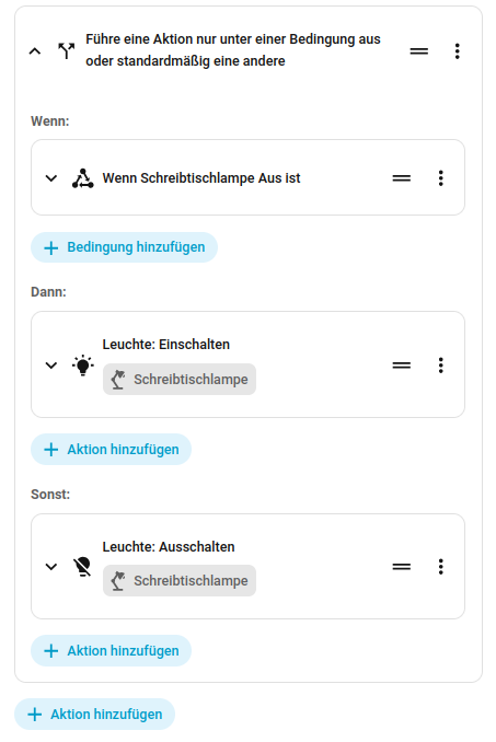

This is the first blueprint i’ve used, and though it’s great so far i’m trying to overload it a bit. Given there are only three actions per button, i’d like to add a a conditional statement to acheive four results. currently i have single=increase light, double=decrease light, longpress=turn off. What id like to do is have the light start at a fixed brightness if the bulb is being switched on. I’ve read that actions end if a condition is false, and it’s hurting my poor programming head to figure out how to achieve that within the blueprint. Is it even possible? Any pointers would be gratefully received :slight_smile:
As action you have to start with an if block, either in UI like this:
or in YAML:
if:
  - condition: state
    entity_id: light.schreibtischlampe_licht
    state:
      - "off"
then:
  - action: light.turn_on
    metadata: {}
      brightness_pct: 80
else:
  - action: light.turn_off
    metadata: {}
    data: {}
