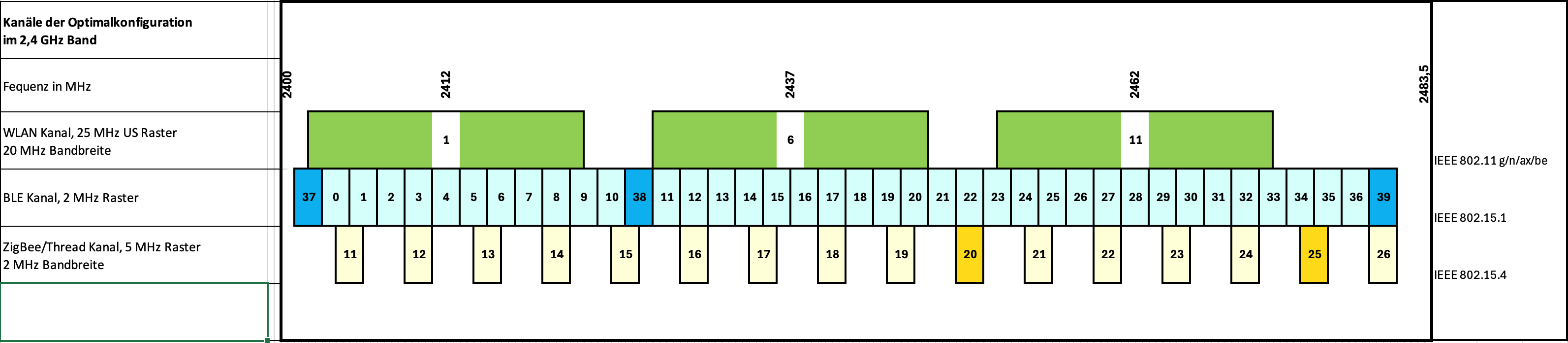

Well apparently the GU10s have pretty weak radios, combined with the usual metal-fittings they are sitting in, you need at least one (better more!) strong FTD at extremly close range to get a reliable connection. Since you are having troubles with their connections, you should be extra aware of interferences with WiFi or Bluetooth netzworks/devices in the vicinity: make sure that the Thread Channel and WiFi 2.4Ghz are not overlapping and avoid auto-channel at 2.4 Ghz WiFi! You should also avoid 40 Mhz Bandwith for 2.4 Ghz in your WiFi Router.
Best practice: 2.4 Ghz at channel 1,6 or 11 and Thread at Channel 20 or 25
See this Chart:
I checked what channels were being used a few weeks ago:
TP Link Mesh is using channels 4 and 6
Router is using channel 11
Thread is channel 25
