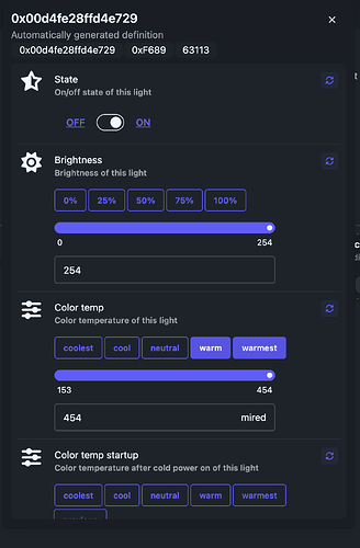

Update: I got a Kajplats e14 to pair to zigbee2mqtt by power cycling it 12 instead of only 6 times. The bulb will flash cold white instead of warm white and then connect without any issues. Brand information is missing however all features seem to work thus far.
This worked.
I read your post while being in ikea and after seeing the Matter Icon I was not sure. So I gave it a shot and voila… 12times switched to Zigbee Mode and HA found it immediately.
Checked with zigbee2mqtt and ZHA (yes I run two zigbee networks)

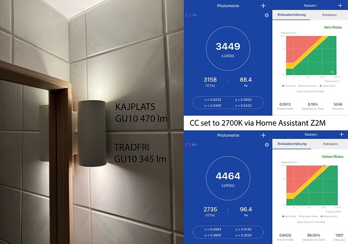

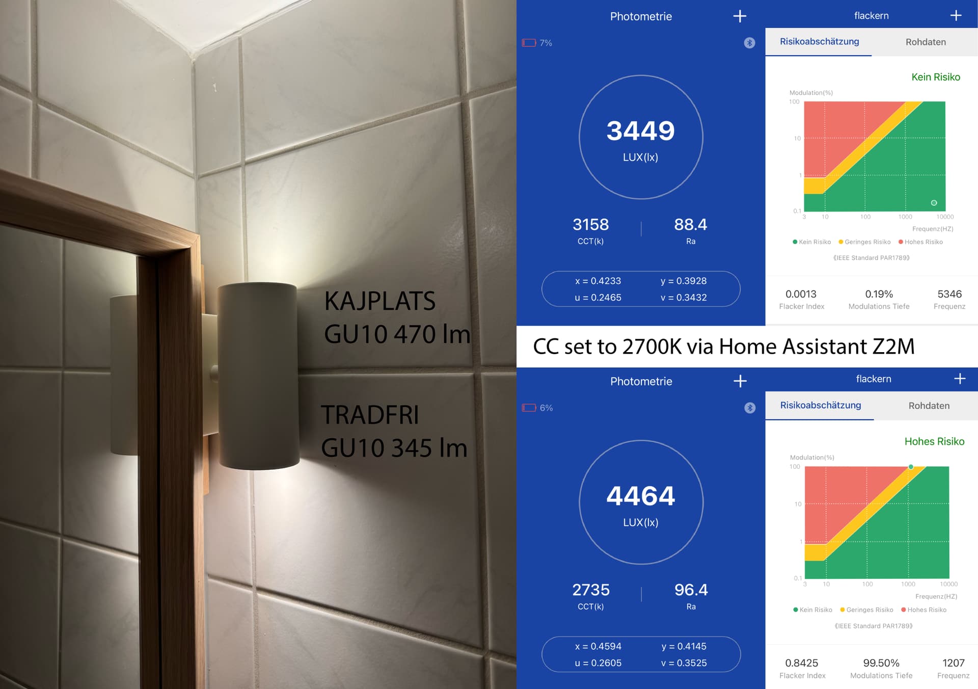

How are the white tones? Can you see the Kelvin range? Previously Tradfri would I my go up to 4000k and also had a slight green tint. They didn’t look ice as Philips Hue ones.
Measured with a Opple Light Master.
By naked eye i can observe a lower CRI and a tint shift towards green. The tradfri, with its slight magenta shift, feels more pleasent. Colors (RGB) in general render much nicer on Kajlats, but when it comes to whites, i could imagine they traded CRI for lm.
I like the new PWM rate. 5000 Hertz vs 1200 Hertz. I measured at 50% brightness and couldnt see any flickering on Kajplats. On tradfri its slightly noticeable when looking across the room.
CC on the Kajplats behaves very strange in the range of 2000K. It turns into this new yellowish Ikea Warmwhite Representation which i have seen on several Ikea LED bulbs nowadays. I seriously dislike this color, as it looks cheap. Around 1600K it turns into a soso balanced, but pleasent reddish. Ok, if you do not have too high expectations. I believe HUE does better here.

Please be aware, that my measuring setup is far from ideal. Also the CRI value i got on the tradfri appears to be slightly too high, but i remember that 91 - 94 is realistic for this series. The LUX measurement is irrelevant, as distance and situation were not equal.

Thank you for the amazing analysis. You can see on your screenshot that the upper bulb has a clear green tint which becomes even more apparent when you take the image and crank up the saturation.
