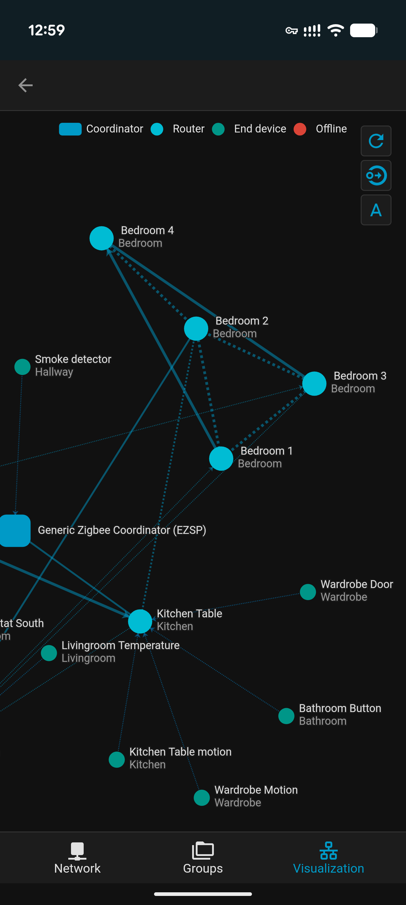

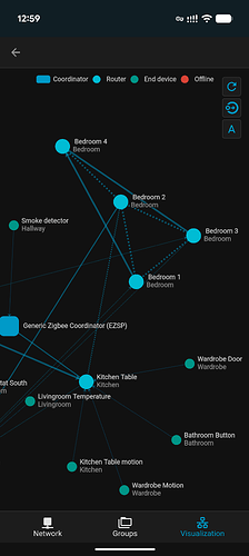

With the generic profile it’s already functional (far I can tell fully functional).
Attached is a screenshot from zigbee2mqtt.

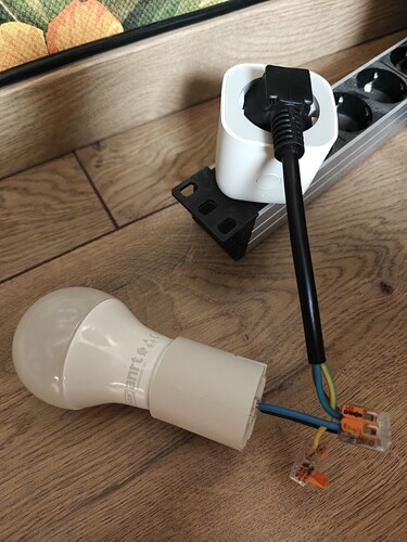

I can easily turn IKEA Kajplats (E27 1521lm) into Zigbee pairing mode with this HA script.
I can pair it to HA (ZHA) with ZBT-2 successfully (no need to be close to the coordinator).
Or I can pair it to IKEA Tradfri hub successfully with a Tradfri On/Off button (keep the pair button pressed on it; no need to be close to the hub).
