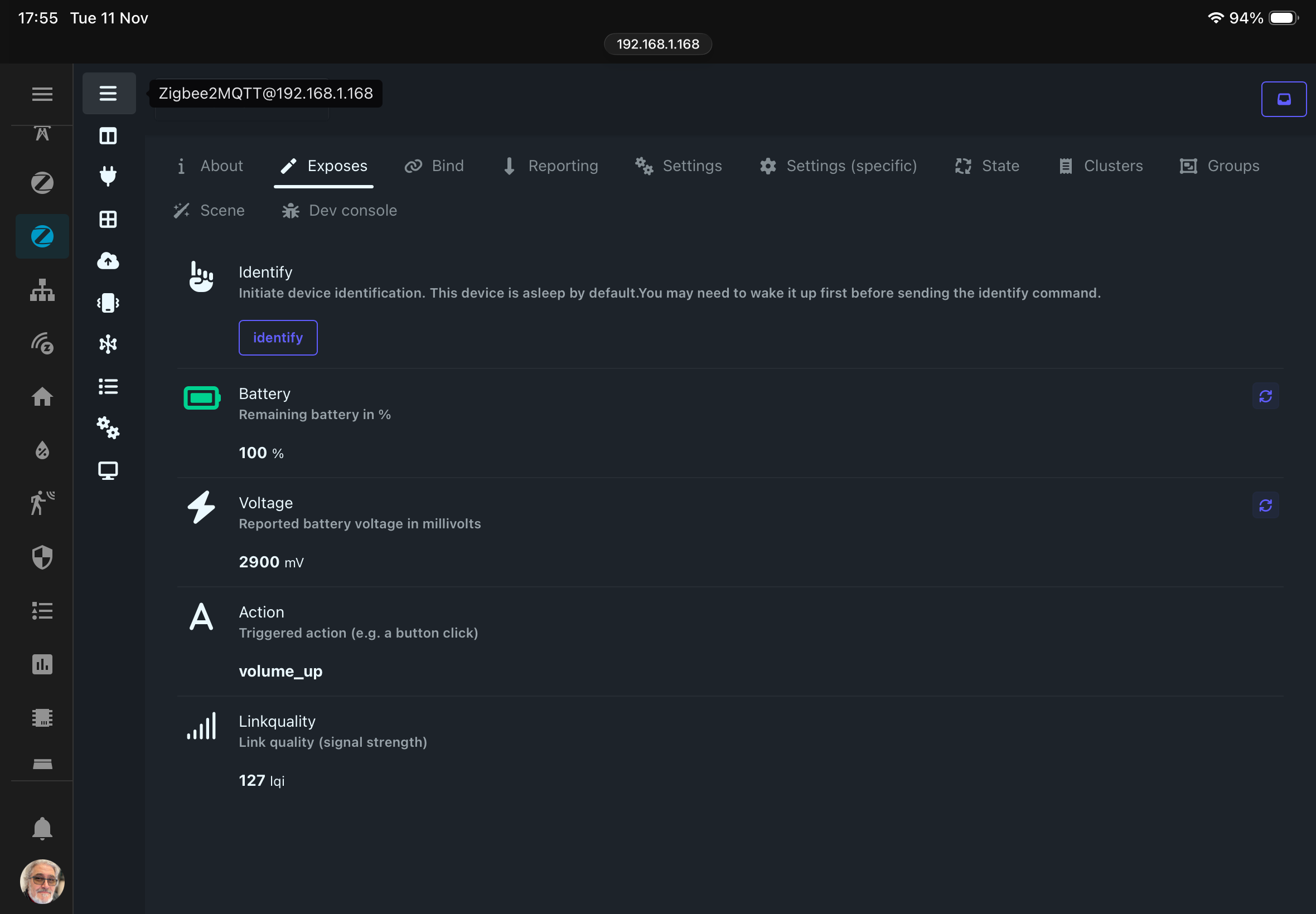

Can anyone direct me to being able to use this ikea remote.
In zigbee2MQTT I can see the device showing all the button presses.

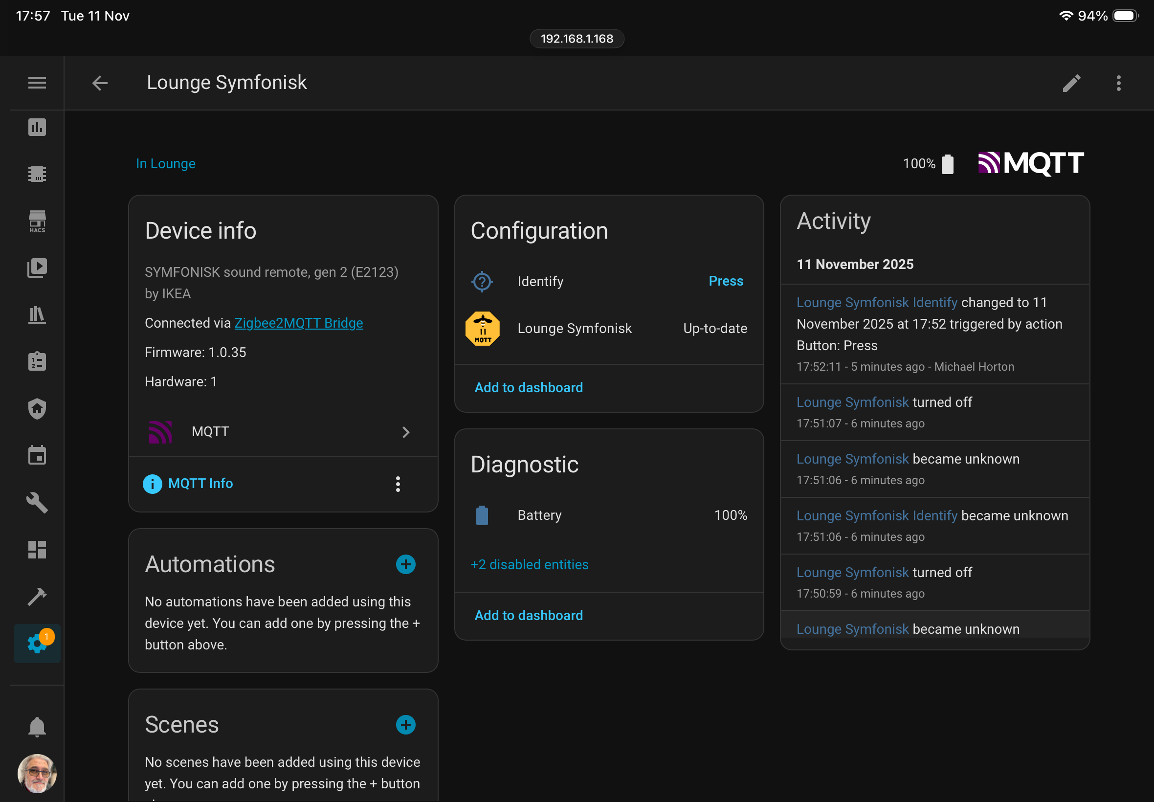

But in Home Assistant I cannot see the button presses
Now over the last 2 years I have built and rebuilt zigbee2MQTT very many times.
I could always manage the device in Node Red, but still curious why device shows in Home Assistant with all the buttons ignored.
see if this helps Using the new action events in Zigbee2MQTT 2.0
Thanks!!
Requires a zigbee2MQTT restart.
Funny though that all the other devices, buttons/switches worked fine.
