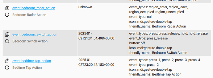

To find the attributes, go to HA Developer Tools → States
Find the event entity for the switch/remote. You can see in the attributes in the right column
This is my Philips 4 button dimmer
event_types: press, press_release, hold, hold_release
event_type: press_release
button: off
icon: mdi:gesture-double-tap
friendly_name: Bedroom Switch Action
The event_types lists the possible event_types. The event_type shows the last received event. And the button shows which button was pressed.
Not all devices have a button attribute. They only use the event_type. I even have a remote where all buttons make an event_type uniqie to each button. Except for long press where the event_type becomes hold and you have to use the button attribute to see which button is held. That is one bad example I have seen this confusing way. Normally it is either event_type of a combination of event_type and button.
I think it is pretty well made. Much better than the deconz_event with mysterious 4 digit numbers I came from.

Hi
I have a Philipps 4 button dimmer
Can you explain how to find the event entity for the switch/remote from HA Developer Tools → States
I don’t see any event in this page for my Philipps device
Did you upgrade to Zigbee2MQTT 2.0?
Also restart HA and refresh browser cache may be needed sometimes
yes i did it and still nothing
First lets see if it is supposed to be there
If you go to Integrations → MQTT and find your device. Click on it.
You should see something like this for a 4-button Hue switch
Note that there is an Events window in center column at the top.
You should see an Action device there.
Unfortunately there is no UI in this view that can show attributes. You have to go to developer tools → States (NOT Actions!)
In the top of Filter Entities you can type event. and you should see your remotes
Here are a sniplet of mine
Strange it is not really the same thing
Something is wrong. Your screen looks like before Zigbee2MQTT 2.0. It is not picking up the changes.
Look at your setttings in zigbee2mqtt.
If you want events to show up, select “Home Assistant experimental even entities”.
You can also select “Home Assistant legacy action sensors” and all is working as before the upgrade tot zigbee2mqtt 2.0
