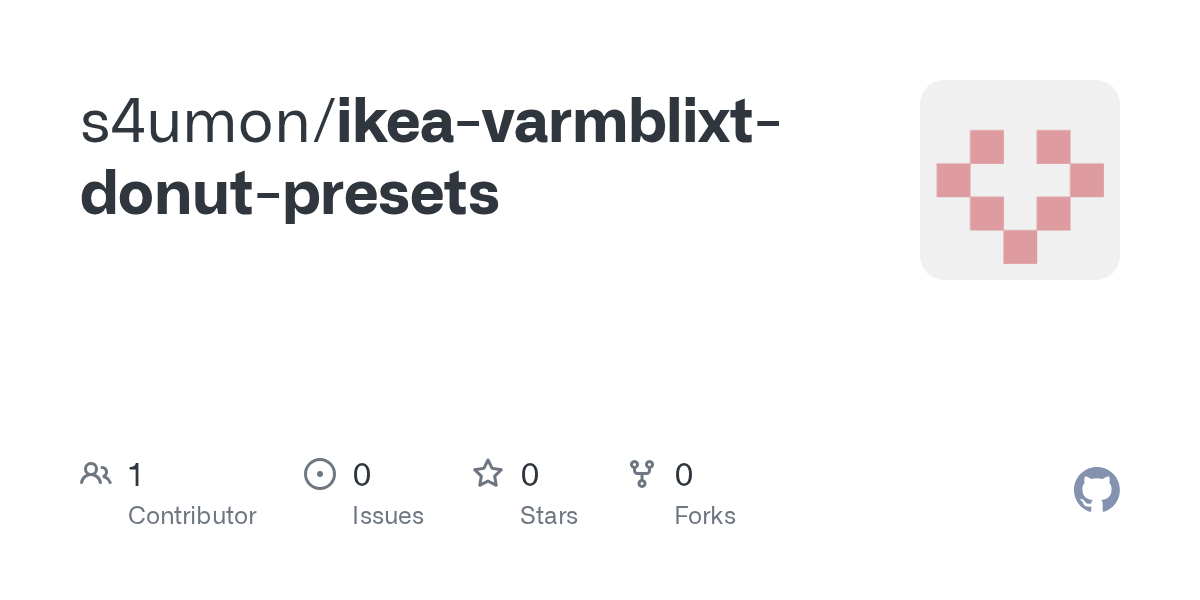

I documented the 12 recovered default presets here:
They are not official IKEA values, just measured from my own lamp, but they should be useful for recreating the double-press colour cycle in Home Assistant.
