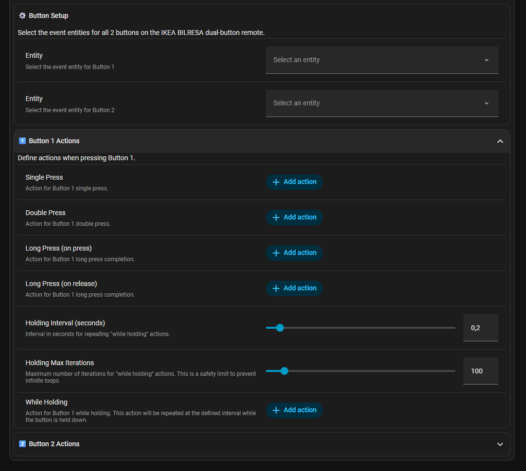

I wanted the IKEA Bilresa dual button remote to be as useful as possible without wiring every interaction by hand. This blueprint gives each button five different behaviors so you can do everything from dimming lights to shuffling playlists without touching a phone.
What you get (per button)
  • Single press
  • Double press
  • Long press (on press) → fire as soon as you hold it
  • Long press (on release) → run something when you let go
  • While holding → repeat an action on a timer (great for volume, blinds, dimming)
Every “while holding” loop has its own interval and a “max iterations” cap so it doesn’t go wild if the remote forgets to send a release event.

Pick your Matter event entities for button1 and button2, plug in actions, and you’re done.

Thanks for a great blueprint! Do you have any suggestions for the parameters to dim/brighten lights? I’ve tried a few values but none that feel completely intuitive as of now, for:
  • percentage change while holding, e.g.,
      brightness_step_pct: -10
  • Holding Interval (seconds)
  • Holding Max Iterations (I’m guessing just doing the math to not go over 100%)
This is really nice!! Thank you for your blueprint… I’m trying to wrap my head around the “while holding”… wouldn’t it be the same as “long press”? For example on a cover entity… long press button2 to close… long release button2 to stop.
First, thank you for the blueprint, it is very easy to use.
I have a problem with the “on hold” action.
When I hold a button, it only triggers about once per second, even though the holding interval is set to 0.05 seconds. Because of that, the light does not dim smoothly.
I’m not sure whether the problem is caused by the blueprint or by my lamp.
Is anyone else experiencing this issue?

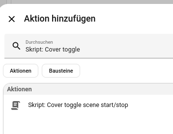

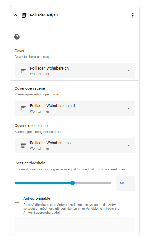

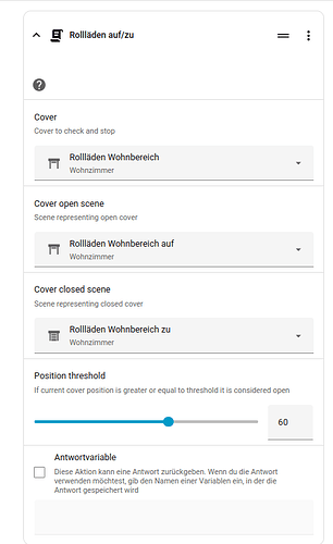

To control different actions with one button I am using some helper scripts which are independent of specific button/blueprint.
For the cover I have Cover toggle scene start/stop which can be used as action for a single button. It toggles between Cover open scene, Stop, Cover closed scene:
YAML code

store as new scene and as action for the button choose
Thank you, I will give this a try.
