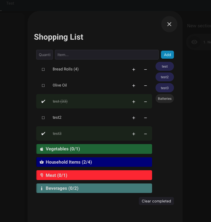

Improved Shopping List Card
I just updated and it looks really great.
The only thing I can’t seem to figure out is how to make it both computer and mobile friendly.
I’m fine with having a separate card/view for mobile, but the issue is that I then need to copy all the yaml from the main card.

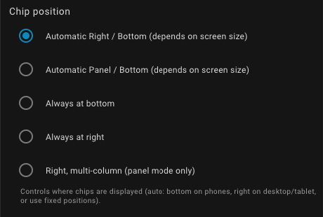

Having panel mode and chip position right is great for computer.
But with that setting I can’t see the shopping list on the phone.
Having chips at the bottom is the best for phones, but not for computer.
Perhaps this is out of scope for what you are doing? But what if there was a toggle button between two modes?

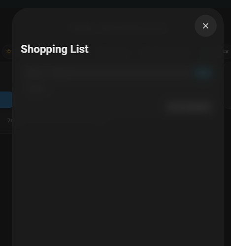

I am getting an odd issue when using this card within a Vertical-Stack with BubbleCard pop-up. The card is blurred out, but other cards in the stack display fine.
type: vertical-stack
cards:
  - type: custom:bubble-card
    card_type: pop-up
    hash: "#shoppinglist"
  - type: markdown
    text_only: true
    content: "# Shopping List"
  - type: custom:ha-shopping-list-improved
    chips_position: auto
    quantity: end
    acknowledged: hide
    chip_click: single
    chip_merge: standard_first
    local_chips: false
    entity: todo.shopping_list
    show_cat_popup: false
    sub_text: " "

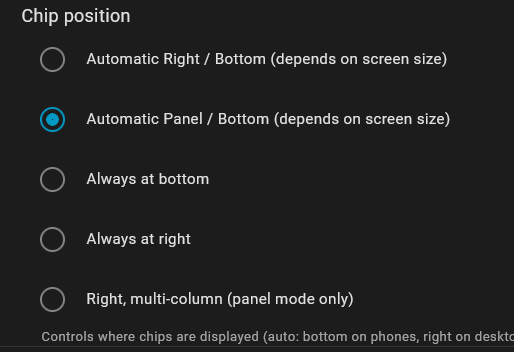

There will be a new option in the next version
so you can use it on your PC (in panel mode) and also on the phone with chips at the bottom.

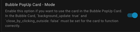

I tried several hours to find the problem.
Bubble popup card is “deeply rewriting” the styling code so that the card can not re-size. If you open the debugger (F12) in your browser, it is possible to see the card due to the resizing.
I am sorry but I have no idea how to solve this issue. :confused:
EDIT: I found a workaround
Will release the update tomorrow
v1.2.0-BETA-5 has been released
Added an option for Bubble PopUp Card
Enable this option, if you want to use the card in the Bubble PopUp Card.
In the Bubble Card, the following settings must be set for the card to function correctly.
background_update: true
close_by_clicking_outside: false
Renamed the chip sorting options and added a new option Automatic Panel / Bottom (depends on screen size) to automatically switch between panel mode and mobile view

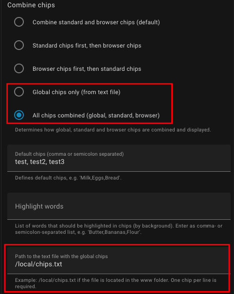

Implemented Global Chips
With this feature, you can save chips in a text file (e.g., via the file editor), and these chips will optionally be available in all cards.
You can also merge the Global Chips with the Standard and Browser Chips.
In the input field, you need to specify the path to the chips file.
Example: /local/chips.txt if the file is named chips.txt and located in the www folder. And yes, local points to the www folder.
Each chip must be placed on a separate line.
You might also need to add the www folder (or your specific folder) to the allowlist_external_dirs in your configuration.yaml and restart Home Assistant afterwards:

I can confirm the Automatic Panel / Bottom works fine.
Thank you!

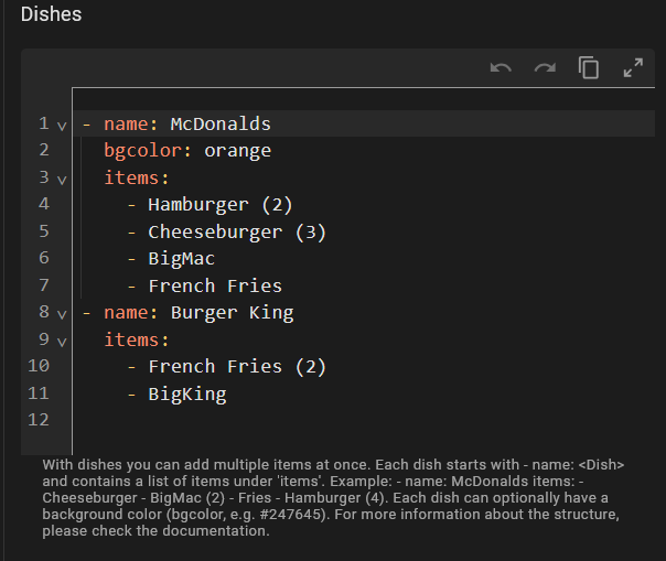

I have to thing about this, if you can work with YAML configuration like this:
dishes:
  - name: McDonalds
    items:
      - Hamburger (2)
      - Cheeseburger (3)
      - BigMac
      - French Fries
  - name: Burger King
    items:
      - French Fries (2)
      - BigKing
its not a big deal
That would be my preferred way of doing it.

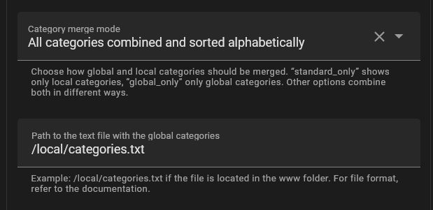

Implemented Global Categories
With this feature, you can save categories in a text file (e.g., via the file editor), and these categories will optionally be available in all cards.
You can also merge the Global Categories with the Standard Categories.
In the input field, you need to specify the path to the categories file.
Example: /local/categories.txt if the file is named categories.txt and located in the www folder. And yes, local points to the www folder.

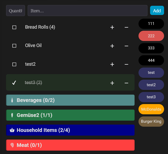

Implemented Dishes
With dishes you can add multiple items at once. Each dish starts with - name: and contains a list of items under ‘items’. Example: - name: McDonalds items: - Cheeseburger - BigMac (2) - Fries - Hamburger (4). Each dish can optionally have a background color (bgcolor, e.g. #247645). Dishes will be always added at the end of the other chips.
- name: McDonalds
  bgcolor: #000000
  items:
    - Hamburger (2)
    - Cheeseburger (3)
    - BigMac
    - French Fries
- name: Burger King
  items:
    - French Fries (2)
    - BigKing

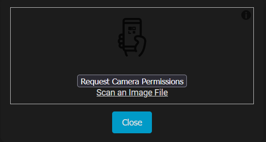

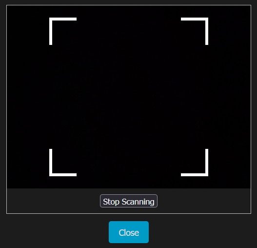

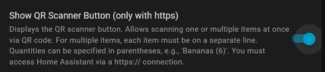

Implemented QR Code Scanner
Allows scanning one or multiple items at once via QR code.
[!IMPORTANT]
You must access Home Assistant via a https:// connection for the QR scanner to work.
QR Button
grafik
You have to allow camera access
Scan the code. If the scan was successfully, the scan window will disappear.
Configuration option:
For multiple items, each item must be on a separate line. Quantities can be specified in parentheses, e.g., Bananas (6).
