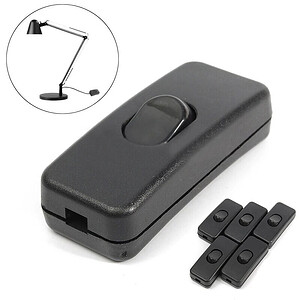

A bit like the type below but smart
Would be a really useful device. I know I can do it with smart plugs, but not as nice a user experience.

You can add a Shelly 1 or 1Pm in these
Not quite the same size but a sonoff basic is a wifi smart switch which works in-line.

Not sure I would want that just hganging out in the wire. I feel they should be tucked away.
Did you maybe confuse it with another device? It’s essentially th same thing (admittedly not as nice looking).

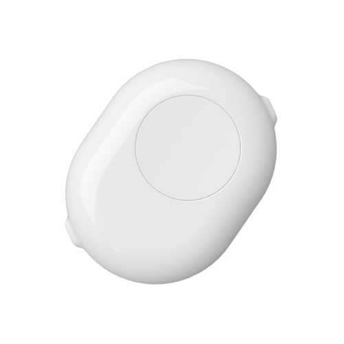

Like @brooksben11 said it is essentially the same type of device with the same brains (esp). I expect the volume also to be around the same - the Shelly button hosts a Shelly relay. Still the later looks probably better and has a nicer form for the task, bad thing only it is sold out.
Using the same solution here, also added a rotary encoder to it for dimming using device group (bulb is running on tasmota)
I’m surprised something like this doesn’t exist. The Shelly Button has been discontinued now as well.
