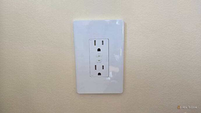

I did manage to find a review of them, though, and, while they similarly seem to believe in their two-dimensionality in reporting the size, they did include a picture of it hanging out of what appeared to be an old-style metal outlet box - definitely looks pretty snug, but, depending on how much of a rats’ nest of wiring it will have to share space with, should be able to fit? Anyway, here’s the link:

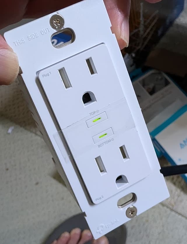

Here’s half the answer (it came a day early)…
First, it doesn’t have pigtails, but rather screw connectors (one on each side, and one ground on the bottom). They look suitable to stab rather than loop a wire and have a notch cut as though it is expected to allow two wires.
The size is roughly rectangular, not a lot of curves, and 44mm wide (side to side), 72mm tall (ground screw may add slightly to that), and 38mm deep (to the back of the back plate not including the metal grounding pads that should compress). There’s a roughly 5mm, 45 degree taper on the top and bottom (but not sides) that should help slightly with wires as that’s where these old boxes have their screw-down clamps.
I’m too tired this evening to pick a box and open it up to see if it fits. It’s about the size of the top greener’s that do not fit (I only have some switches out, not outlets, and it’s almost identical to those). So I am not optimistic. Though screw vs pigtails does give me a bit of hope.

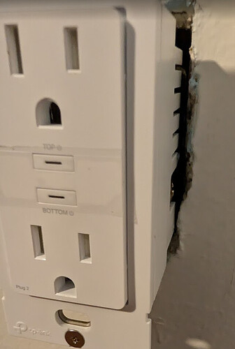

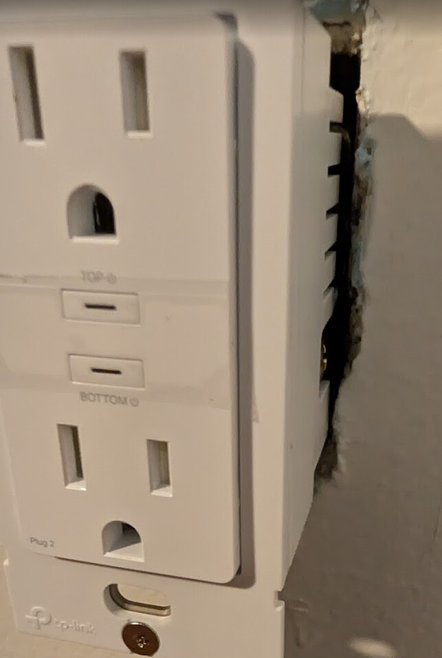

Well, it’s close, but it will not fit. It hits on the sides slightly (the outlet may not be completely square), but worse the top and bottom hit. Even if they didn’t, the cross-nail that holds it to the wall is not deep enough for it to go all the way in.
I would end up having to cut these out and replace with a full size box. I’m not sure I have any more that I need badly enough to do that. Maybe.

Ah… I found it. Well, I found the pairing numbers.
See the plastic rectangular ring around the outlet? It’s held on by the two screws. Directly underneath it along one side is the 11 digit pairing code.

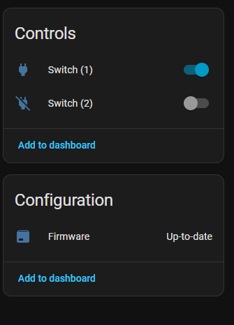

I paired it, it added immediately, and…
There’s NO ENERGY SENSORS.
What a waste of a lot of time. It says right on the box “Energy monitoring”.
Sigh…
