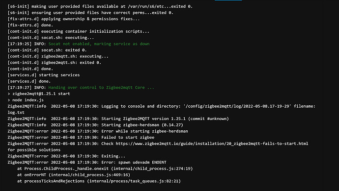

I have attached the log. Do you know what the problem may be?
No idea, have not seen this. I have changed the zigbee channel a long time ago, only thing to remember was to delet the config.backup file, as it will not change anything if this file is excisting.

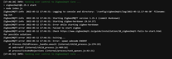

I attached a the log of mqtt in my earlier message. There seems to be consistent error of zigbee herdsman not able to start.
OK, Got a little confused by you mentioning MQTT, as the problem is Zigbee2MQTT core according to the log above. The configuration.yaml and log.txt files might give a describtion of why it will not start.

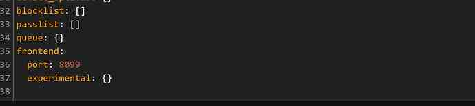

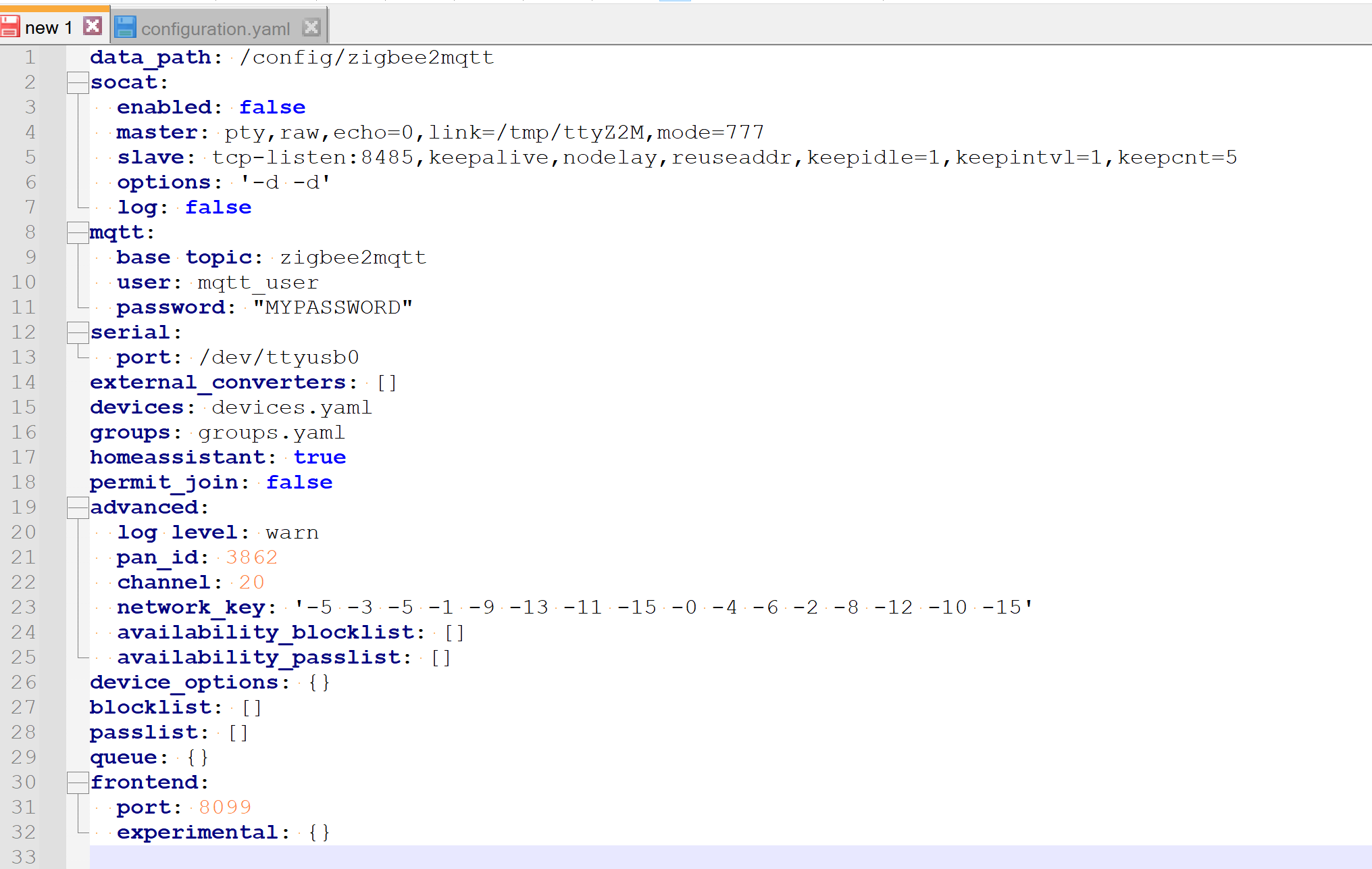

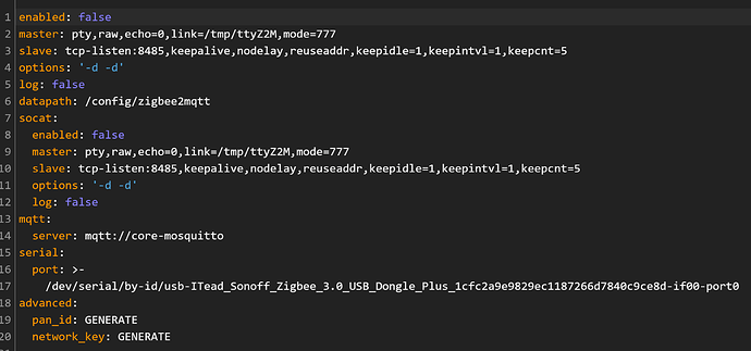

The pictures on the top are from the config file directly and the bottom one is from the add on. (Not sure if they are any different)
The channel seems to be different, even though I changed both to be 15
Channel is set to 11 and 20. Not sure how you got them different. Try and set it to 15 in the add-on configuration, then delete the backup file “configuration.yaml.bk” in the zigbee2mqtt directory, Check the configuration.yaml file have the correct channel. Do a restart. Z2M will only do changes to the configuration if the .bk file is deleted.
If this makes Z2M working, however still having problem pairing devices again, change the PANID. When I changed my network key, I got some issues with re-pairing. This was solved by changing the PanID.
You serial port is directly to a USB port. This can give problems if the dongle is move between USB ports. Under hardware there is a option called “all hardware” (you need to press the 3 small dots in the upper right part). You should be able to find you direct port there. Mine is : port: >-
/dev/serial/by-id/usb-ITead_Sonoff_Zigbee_3.0_USB_Dongle_Plus_d617560171d9eb11bf30158e6fe9f4d9-if00-port0
If I understand the z2m source code correctly, network_key should either be an array or a string saying GENERATE (to generate a new key). In your case it’s a string containing the key, which would seem invalid.
Try changing it to GENERATE to see if it will at least make z2m start up again:
Thats the config on home assistant: As you can see, the config on home assistant is not updating to the new one. Even after I deleted the entire aigbee2mqtt folder and installed z2m again.
