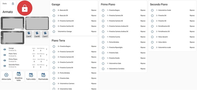

Following the instruction of Nikitarex, and using my SmartLiving 1050 with SmartLAN/SI, I can now show my dashboard. The only problem is the extremely slow update of the zones from the cloud.
