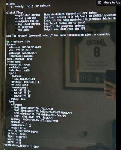

Forget about pinging homeassistant.local for now and focus on LiQuid_cOOled’s post above.
Your HA is telling you that it’s sitting on 192.168.0.51, but somehow your router (or something) is trying to reach it on 192.168.68.53.

What’s the IP address of your router? Is is 192.168.0.1 or 192.168.68.53?
