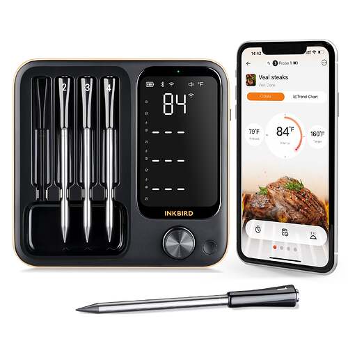

Any idea if I would be able to use this to pickup data from the newer wireless Inkbird BT/Wifi models (INT-12-BW & INT-14-BW)
