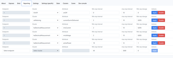

For me the problems disappeared after adjusting the timings under “reporting” tab.
Hi, where or how can I find the table in your screenshot?
Thank you!
Open your device properties in Zigbee2MQTT
