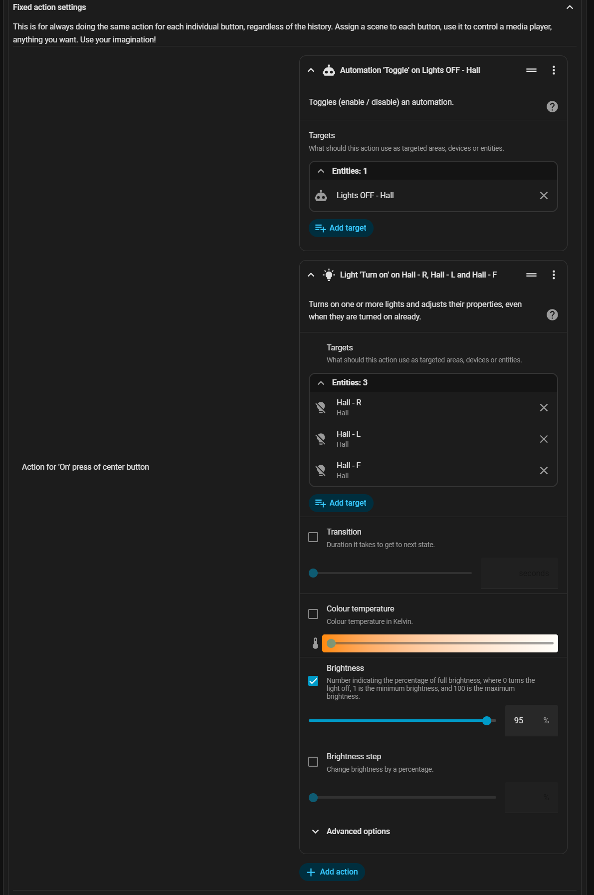

  • The first mode is the most versatile, it allows you to create an action for each type of button press. This can be any action you want. Any button you do not configure will trigger the automation but it won’t send any action. The long presses can be assigned to actions but there is no looping, only a single instance of an action is done on a trigger. If you want looping here, you can make scripts that implement the looping and start/stop the scripts with the actions.
  • The second mode stays close to the built-in way the remote works. It allows you to cycle through a fixed list of five scenes with the left and right buttons. The scenes can be any kind of scene, they don’t need to be light scenes. The up and down buttons will increase or decrease brightness of one or more lights, the on/off button will turn the ligth(s) on and off. The scenes and light(s) can be selected in the blueprint dialog, they must be specified as entities. A seperate section for configuring a few parameters is present in the blueprint.
