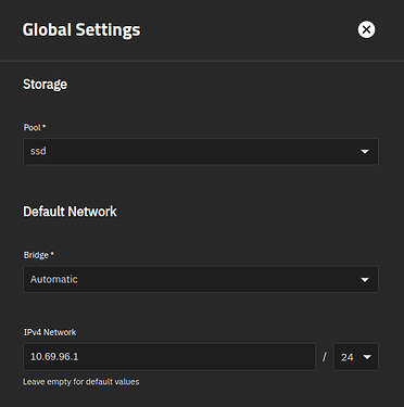

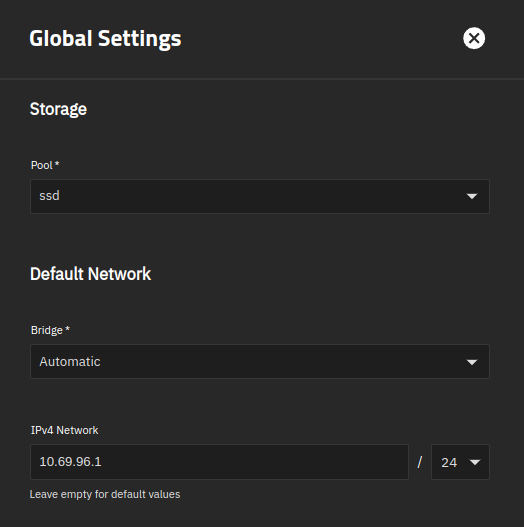

I’m not doing anything fancy. The TrueNAS network settings are basically default. I have a static IP instead of DHCP, and I do not have a bridge set up in TrueNAS.
On the Instances page, under Configuration - Global Settings, The Default Network is using the default settings.

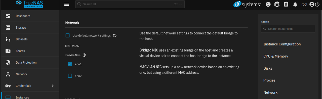

When creating the VM, I unchecked Use default network settings, so it used MAC VLAN instead.

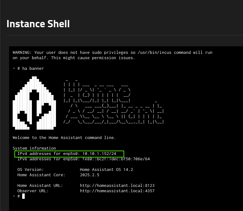

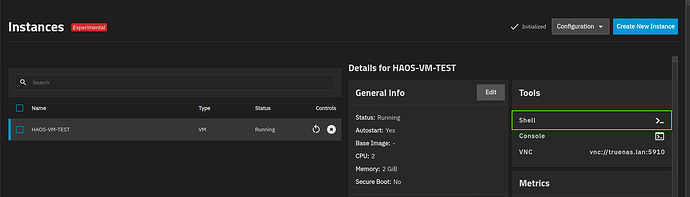

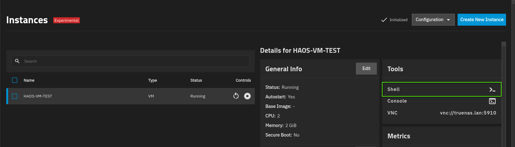

If you go to the VM Tools and then click the Shell button, it opens a terminal. Type ha banner. Can you confirm Home Assistant is fully started and has the expected IP address?
EDIT – Upon further testing, I still need to create a bridge on TrueNAS in order for the VM to connect to it. For example, using TrueNAS host as a remote backup location for Home Assistant
