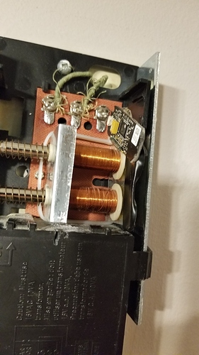

What if you turn the sensor to the side. So the side with the arrow is pointing towards the coils?

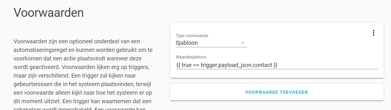

I use zigbee2mqtt. Doorbell rings, xiaomi sensor -> state true to mqtt -> payload âcontactâ: true.
But sometimes after a while i receive another payload with âcontactâ: false. (payload â{âcontactâ:false,âlinkqualityâ:118,âbatteryâ:80,âvoltageâ:2965}â)
The automation has a optional field payload. But donât know what to fill in there to have it only reacting on the true-state?
Have tried âtrueâ, âcontactâ: âtrueâ etc. But that doesnât work.
You can specify what triggers it. Any change, only change to on, only change from off to on etc.

Ok. But what can i fill in the field payload to only trigger on the true-state of the mqtt payload?
EDIT:
Okay, solved that. Filled in the template-value inside condition.
But saw that true from the contact-field was written without quotation marks. It was not possible to delete them inside the gui. Edited that in the automations.yaml.

I canât get mine to work reliably. Sometimes I get it to report âclosedâ, but then it doesnât reset to âopenâ again.
Has anyone tried a similar hack, but with the vibration sensor? Or is that not sensitive enough?
Hello boneless,
Thanks for you great idea! I have bought the Xiaomi wireless door sensor and tried to place it somewhere near the electro-magnets but no luck so far. Do you think it is possible to place it somewhere without removing the top from the sensor or the top of the case of the electro-magnets? Or is the signal to weak to make it work? Otherwise I have to try to crack it and look whatâs inside

I think it is a bit of a hit n miss honestly. Opening the sensor is quick, so that would be my first try, but not sure if it would help.

I have opened the sensor, removed the relay and connected the two switch-wires to the two points the relay was soldered to. I also placed a 100nF capacitor between the two contacts, that helps to avoid âfake ringsâ when it rains (due to elektrostatic discharges).
This works very well for me
I did the same had to remove it from the casing. Love when all my Alexas say âsomeone rang the door bellâ

You didnât break or removed anything from the sensor but just connected two switch-wires on both sides of the âbarâ as show in my picture? And theses wires are directly connected to the relay? Do you have any photoâs you could share? I also search on the Internet for the 100nF Capacitor, I found them with 50V, do you mean those? I did study electronics, so I can soldered, but the theory of connecting capacitor is gone.

I did remove the relay that you show in your picture. In its place I soldered the 100nF 50VDC capacitor, a through-hole type, not as SMD-type. And then I soldered the two wires of the doorbell-switch onto the two capacitor wires, one to each side of the capacitor. Thatâs all.

Thanks for your replay. I really going to try it but I will first remove the hood of the electro-magnets en try to place the uncovered sensor somewhere on top of it to see if it works. With no succes I will have to order a 100nF capacitor online
