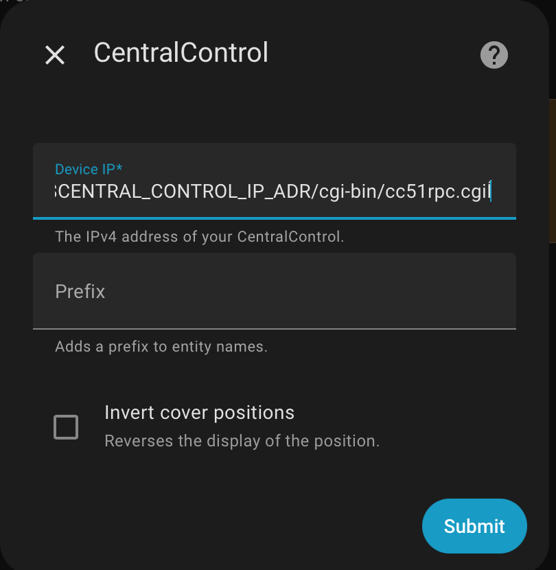

I’m fairly new to the HA world and my programming skills are a little rusty. I’m stuck at an earlier stage and wanted to ask for some advice: When adding the integration, it asks for a ā€œDevice IPā€ – what should I enter here? I took the information from the ā€œBecker CentralControl HASā€ page and entered ā€œhttp://$CENTRAL_CONTROL_IP_ADR/cgi-bin/cc51rpc.cgi.ā€ I suspect I need to adapt this to my local situation. Sorry for the noob question. I’ve been stuck on this for quite a while now.
Just to add a few more information: HA is hosted as own OS on a HA Yellow. Centronic USB with number 4035 200 041 0 is already connected to this stage. And I also adapted the configuration.yaml.
Thanks
Can you post a screenshot? For me I don’t think it asked for an IP rather the device path
appears after I look up for Becker and I push on CentralControl to add it as integration

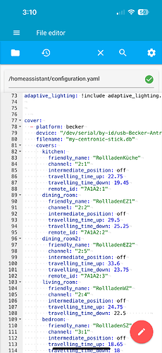

You have to edit the configuration yaml file as mentioned in the readme.
The old-school way :wink:
Mine looks like this.
It should be explained quite well in the documentation of the integration
Thanks for the quick responses. I managed to do it—the other integration led me in the wrong direction.
