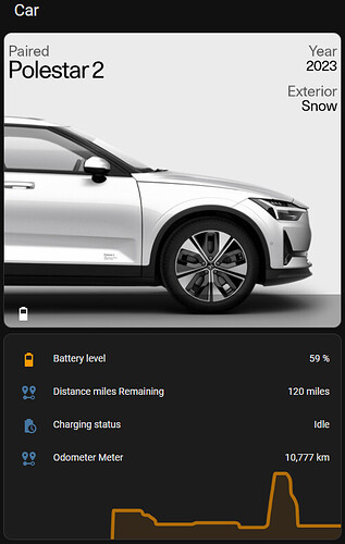

Here is my dashboard if useful to anyone else:
type: grid
square: false
columns: 1
title: Car
cards:
- camera_view: auto
type: picture-glance
image: /local/Polestar2.png
entities:
- entity: sensor.polestar_7241_battery_charge_level
- type: entities
entities:
- entity: sensor.polestar_7241_estimate_distance_to_empty_miles
- entity: sensor.polestar_7241_charging_status
- entity: sensor.polestar_7241_current_odometer_meters
state_color: true
show_header_toggle: false
footer:
type: graph
detail: 2
hours_to_show: 168

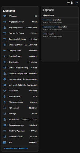

While charging, ‘charging current’ and ‘charging power’ remain “Unknown”, and ‘charging time’ just sits at “240 minutes” for me. Is that just me?
When I first started the integration ‘Model’, Vehicle registration’, and ’ VIN’ showed correctly very briefly, ever since they just show ‘Unknown’. Is that just me?
And, can I make a few suggestions:
- The unit for energy consumption should be “kWh/100km”.
- “Average Speed Per Hour” is weird, should be “Average Speed” with the unit “km/h”.
- “Odometer Meter” should be just “Odometer”
- Default odometer number of decimals should probably be 0
- Generally the capitalization of the friendly names is inconsistent.
To clarify some of my own queries after finishing a charge:
The ‘Charging time’ shows the estimated time to finish the charge, first at a resolution of hours (60 min) and then at a higher resolution (first 15 and then 5 min) towards the end of the charge. Makes sense.
The ‘Model’, ‘Registration’ and ‘VIN’ showed up correctly a few times just after installing the integration, but then never again. Don’t know what’s up with that.
Also the ‘Charger Connection Status’ shows correctly as ‘Connected’ or ‘Disconnected’, but it does not show a history?
The API seems to be a bit flakey and goes up and down a lot, but isn’t detected. If you find a lot of unknowns for the sensors etc, then just reload the integration and it will pull the information in.
I have seen the information go quickly as well, the API token expiry time is usually old, so it hasn’t refreshed correctly.
