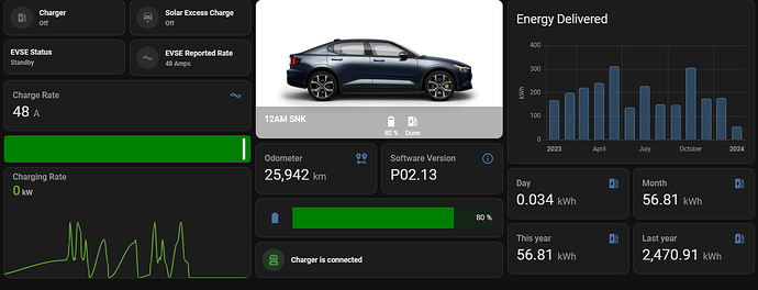

I’ve updated my EV dashboard to use data from this integration and rearranged it a bit. The rest of the data comes from my Emporia EVSE charger and its integration.
The “Charger is connected” state is one coming from the EVSE because the Polestar integration was showing it as disconnected. It updated to Connected a bit later.
