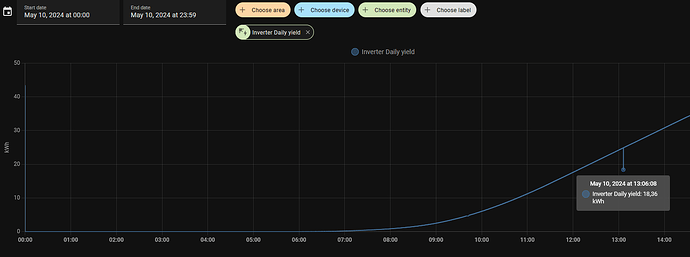

Hi Guys!
I’m using this integration with a SUN2000-6KTL-M1 without problem.
I noticed some days, my Solar production go crazy in the Energy Dashboard, like today between 13h and 14h.
I can manually correct erroneous values in the Statistics but the problem is repeating and that’s not the source of the problem.
Energy Dashboard takes “Inverter Daily yield” as input to calculate the hour by hour yield. Checking the number in “Inverter Daily yield” shows decreasing value samples during the day, which is not supposed to happen:
Sample rate is one every 30 seconds and the erroneous sample is between two legit samples!
It makes the hourly yield calculation gro crazy and adds up delta between erroneous sample and legit one to the hourly yield.
I was wondering is there is a way to have an equivalent of “total_increasing” that ignore sample value if they are lower than the previous one ? (for the Daily, it is reset to 0 at midnight but that’s not a sample, it is a counter reset)
Many thanks for those who can help me in the journey to understand from where those rogues samples are coming!
PS: those samples are also reflected in Inverter Total Yield at the exact same time
